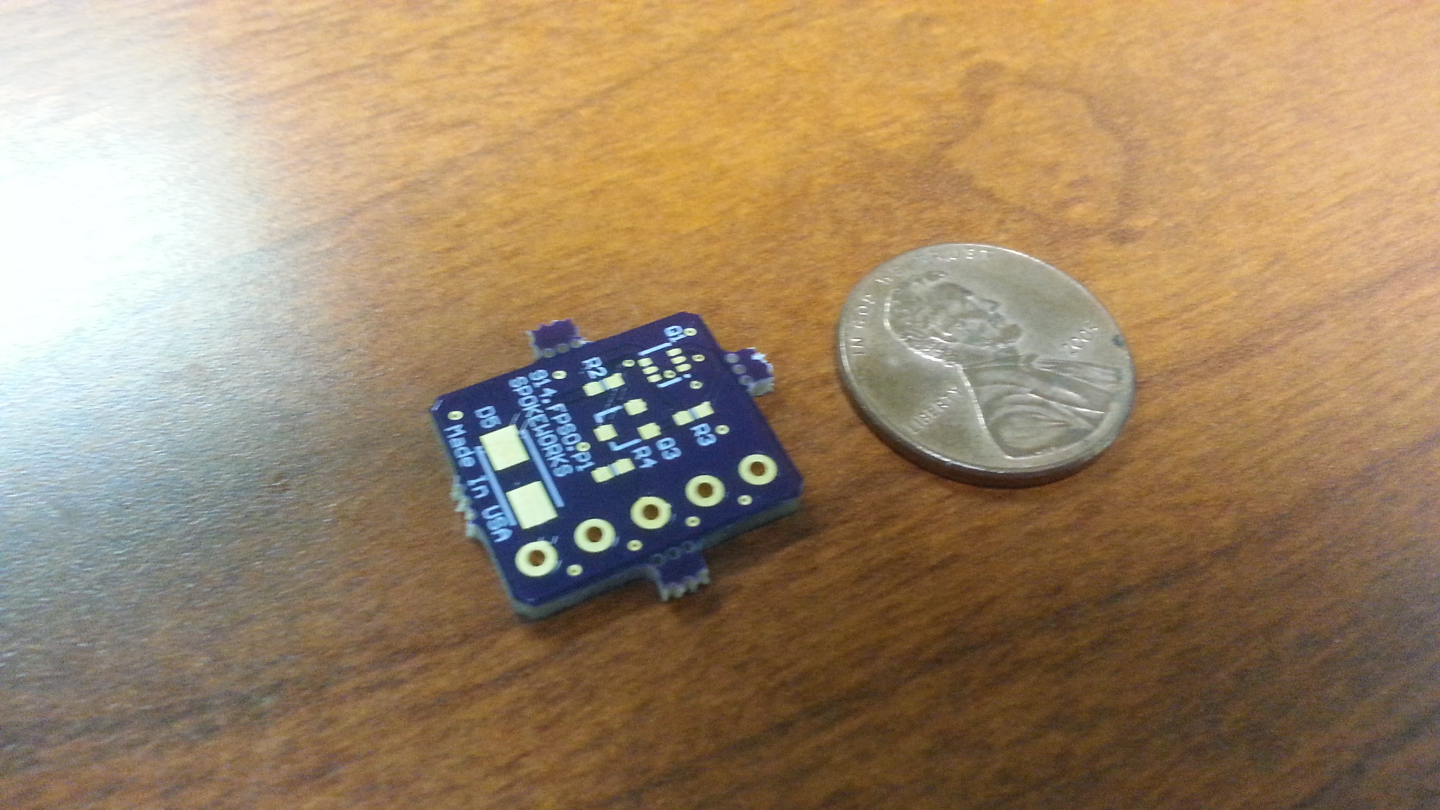

Spoke
post Aug 7 2015, 09:02 PM
Jerry
Posts: 7,185
Joined: 29-October 04
From: Allentown, PA
Member No.: 3,031
Got the boards back. Gotta order a few parts then assemble and test. As I mentioned before, they are tiny.
