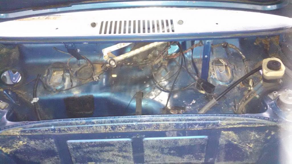

boxsterfan   Day 2 of progress. Front of the floor pans looks ...   Jun 7 2015, 07:56 PM
boxsterfan   Pedal cluster close-up and shot inside the tunnel ...   Jun 7 2015, 07:58 PM
boxsterfan   Driver's rocker:   Jun 7 2015, 07:59 PM
boxsterfan   Passenger rocker: Note: You'll see some black...   Jun 7 2015, 08:01 PM
boxsterfan   More passenger jack point area and Gas tank area:   Jun 7 2015, 08:03 PM
boxsterfan   Head light channel areas (rusty):   Jun 7 2015, 08:04 PM
boxsterfan   Front trunk and channel area:   Jun 7 2015, 08:06 PM
boxsterfan   More front trunk:   Jun 7 2015, 08:07 PM
boxsterfan   More front trunk:   Jun 7 2015, 08:08 PM
boxsterfan   Last pics for the day of front bumper area:   Jun 7 2015, 08:09 PM

boxsterfan   Some things to note: 1. When I took the rocker pa...   Jun 7 2015, 08:24 PM

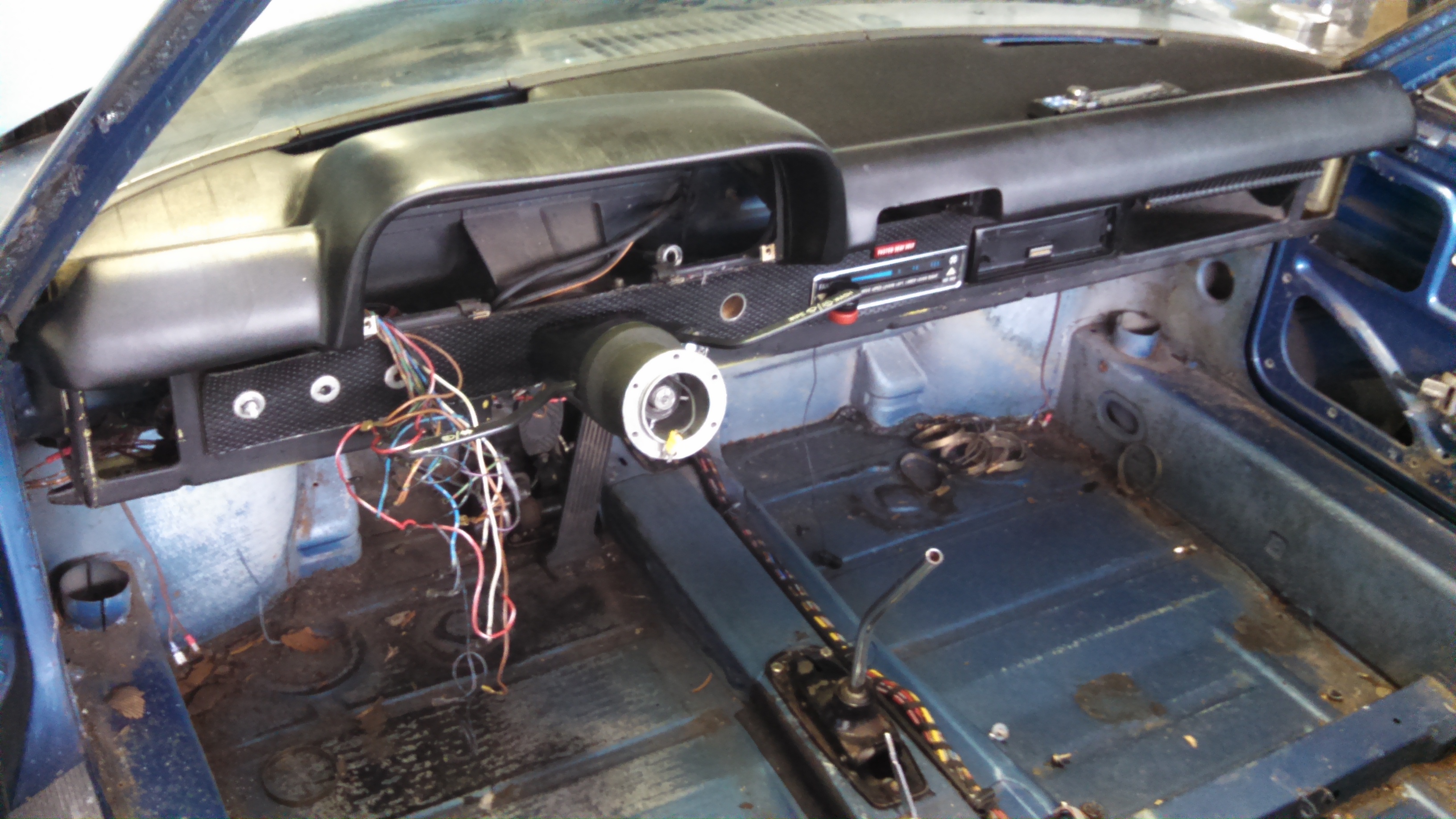

boxsterfan   So I haven't had much time to work on my 1974 ...   Sep 12 2015, 09:59 PM
boxsterfan   Cowl and dash started.   Sep 12 2015, 10:00 PM
