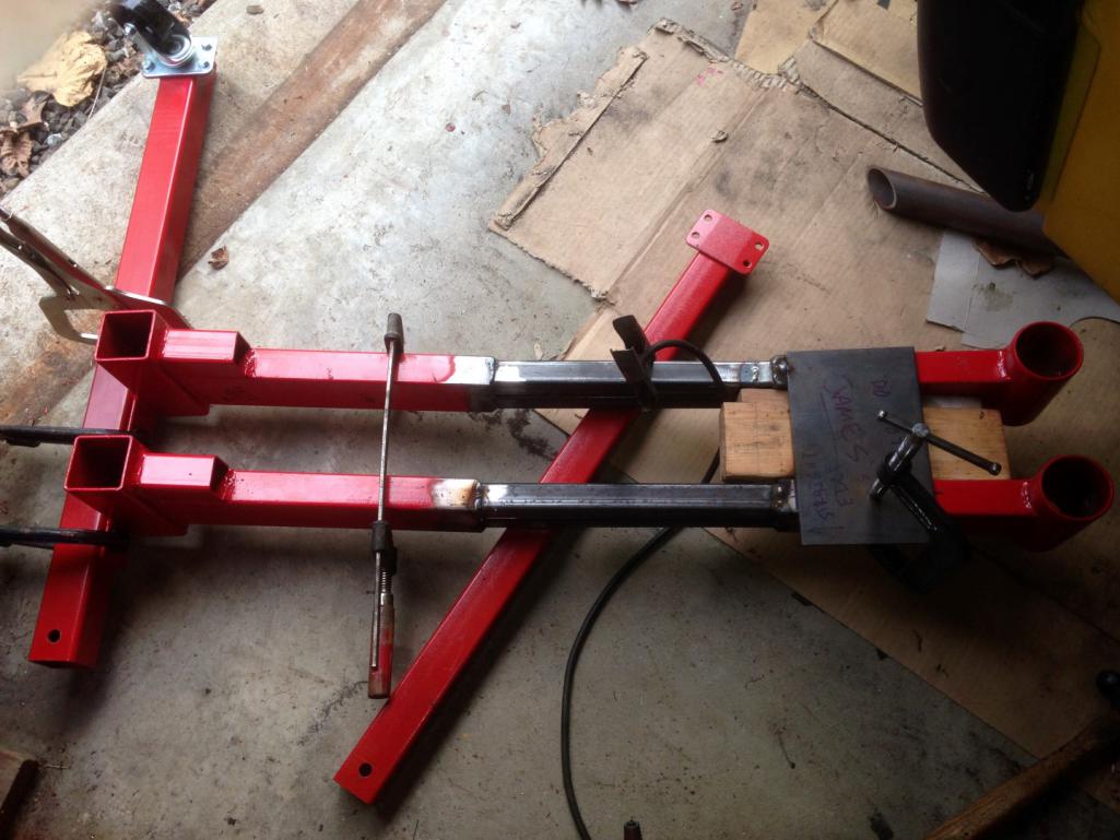

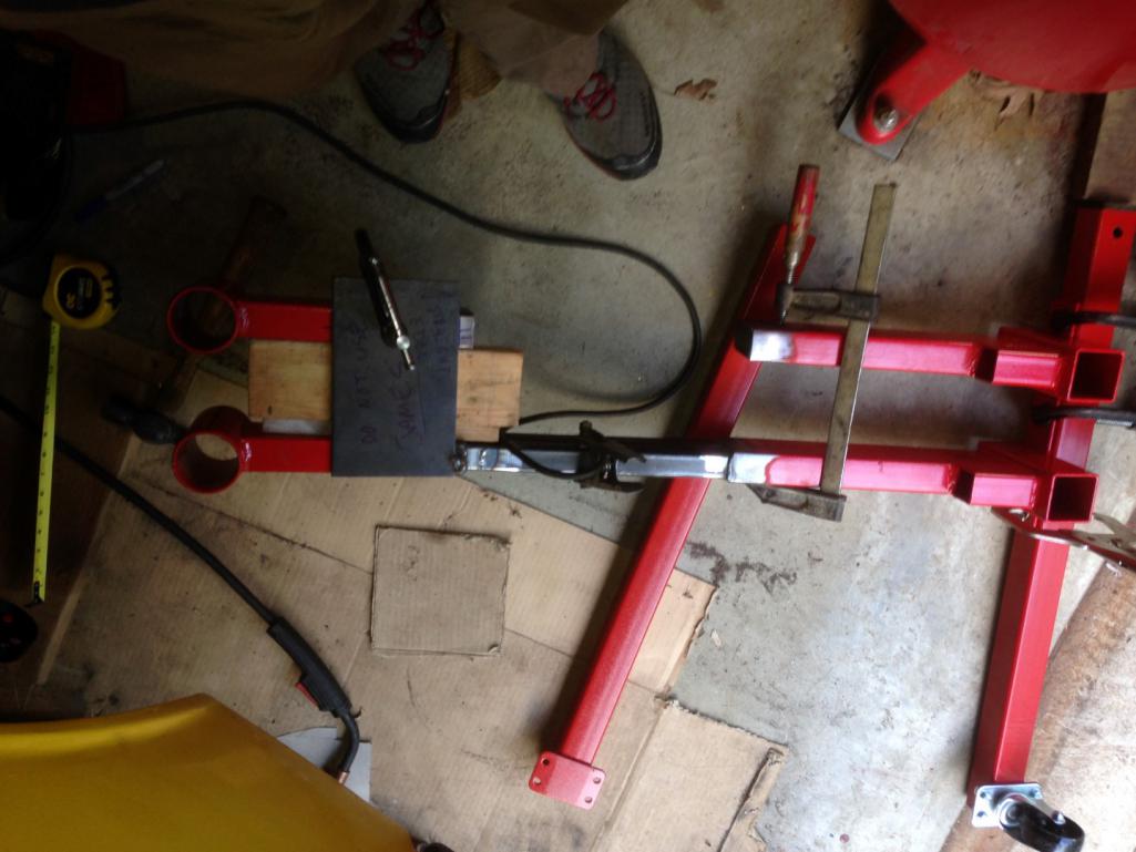

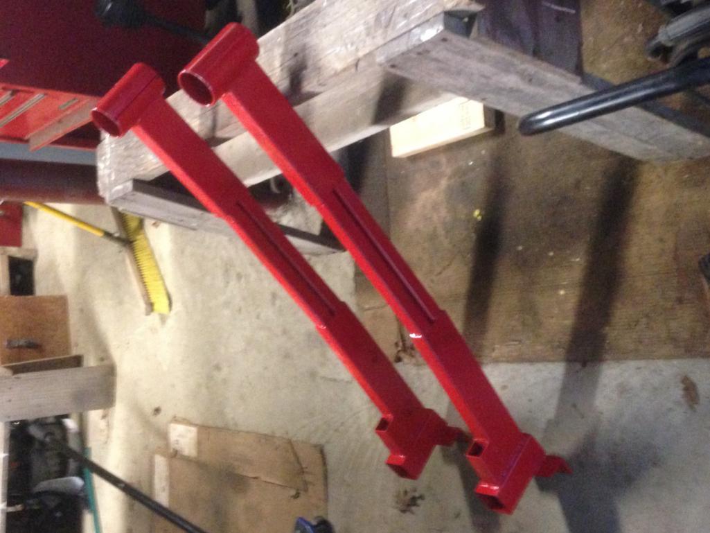

Finally did a little more work this weekend after a long hiatus with a lot of work, an almost move to KY, and a bunch of other people's projects in between.
I've been spoiled by working on cars that don't require welding or painting upside down and decided to build a rotisserie to reduce the amount of overhead welding on all of the suspension mounts. This time around the whole bottom will be stripped, repainted, and undercoated which will also be nicer to do on a side. My goal is to make a quick and dirty one to not take much time away from the overall car build so I'm modifying 2 cheap engine stands to do the job. They don't have pivot bearings so hopefully the car won't be too hard to turn, but I guess I'll cross that bridge in a few weeks when loading it on.
To try and avoid having the longest car build ever I'm trying to spend at least half a weekend day per week working just to make a little progress. (IMG:style_emoticons/default/laugh.gif)
First step was to cut apart the vertical leg, add about a foot of metal. This results in a pivot-to-bottom brace height of 38", giving about 3" of safety factor from the widest point of the car to brace. The pivot also needed to be made parallel to the bracing as the engine stand was tilted non-parallel. Next was to repeat the modifications on the second engine stand leg. After a whole bunch of hack fixture and a bit of welding the second stand was done too. Note that (2) pieces of 1.375" square x 0.1875 wall steel were used since I didn't have any of the correct 1.5x3x0.100" box beam. It should be plenty strong enough for a light car though.
Next week's goal is to get metal to make the arms to attach to the bumper mounts, some cross bracing, and connect the 2 stands under the car. (IMG:style_emoticons/default/smile.gif)
