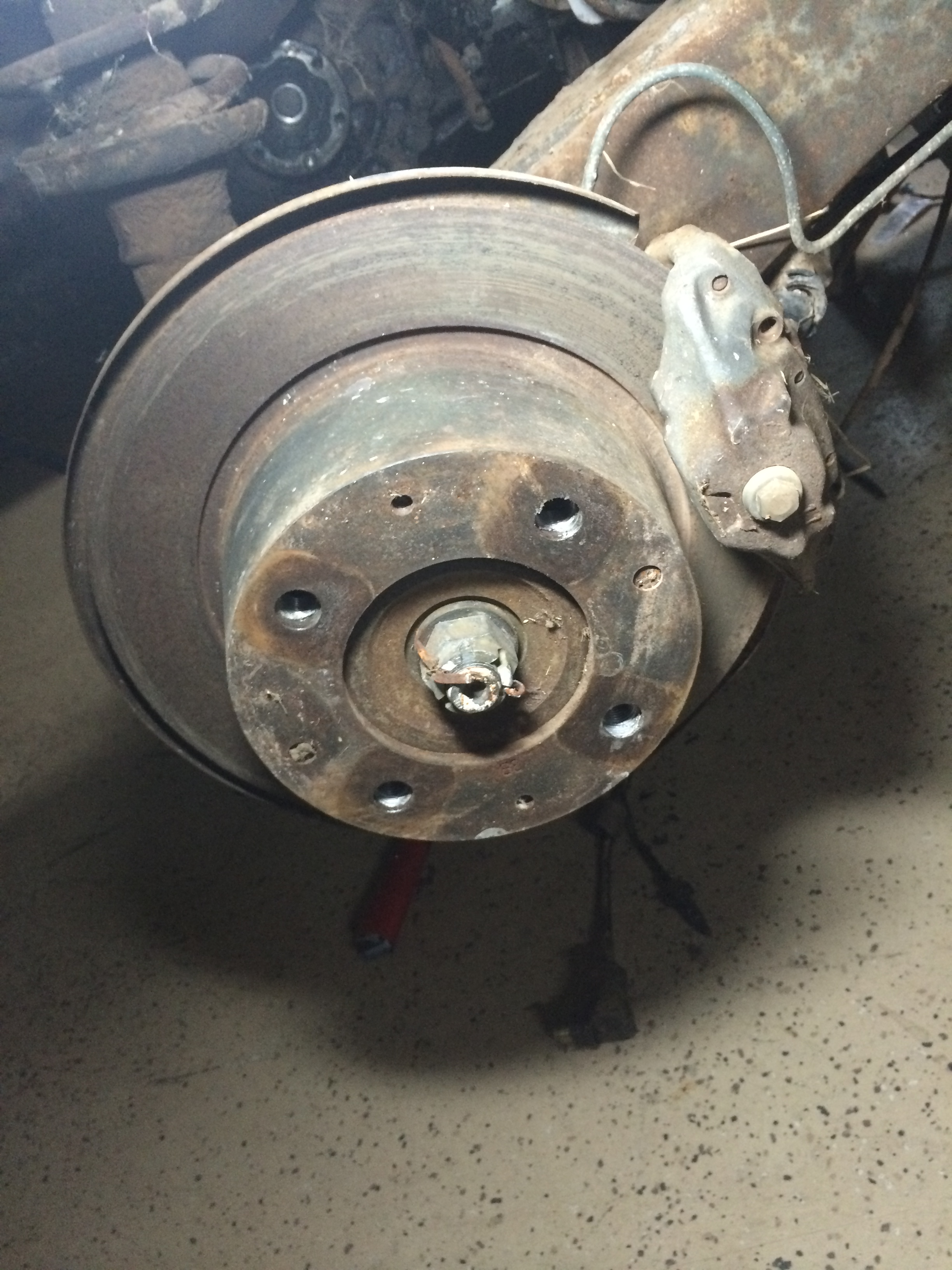

EFI has been replaced by some sort of carb setup. This will be my first experience with a carb engine. Any suggestions on how to get the motor going? I need to make sure it turns by hand first.

Planning on a 5lug swap using the PMB drilling method. (IMG:style_emoticons/default/biggrin.gif)

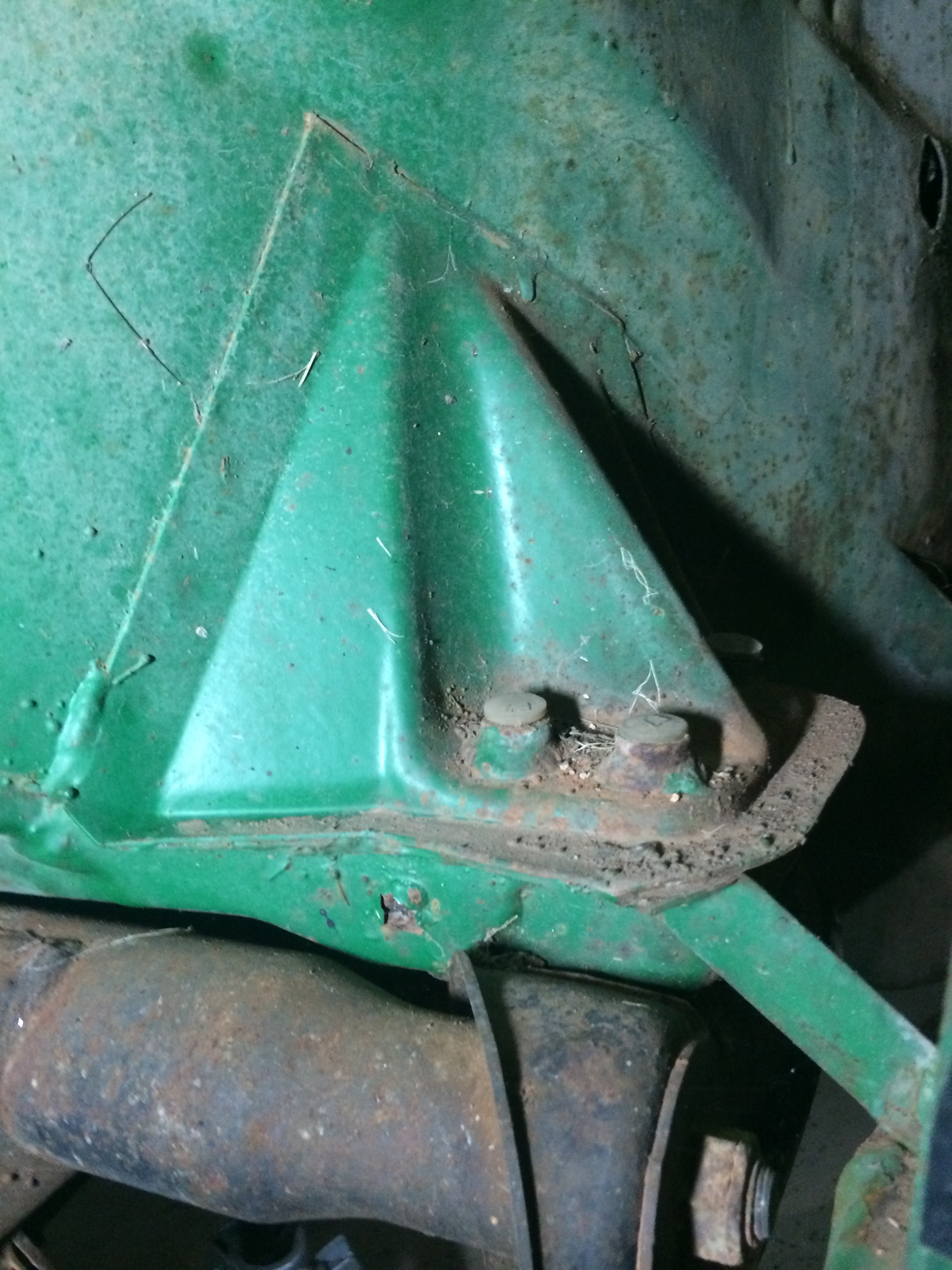

jmitro   Hell hole will need replacement on both sides, the...   May 28 2016, 11:16 AM

jmitro   finally almost finished on the hell hole and entir...   Aug 28 2016, 08:39 AM
