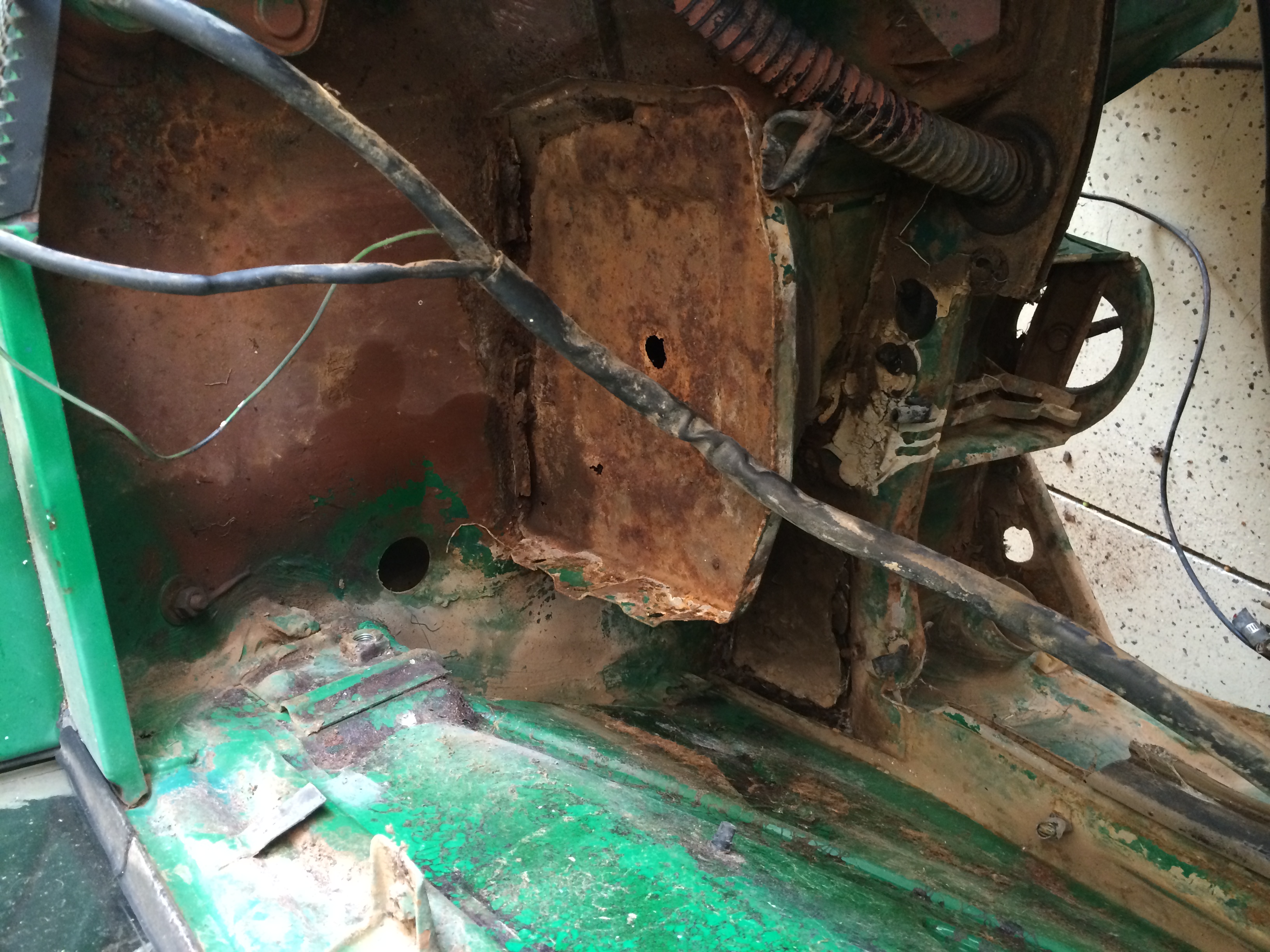

jmitro   Well the car has become a full restoration of sort...   Sep 17 2015, 10:37 AM

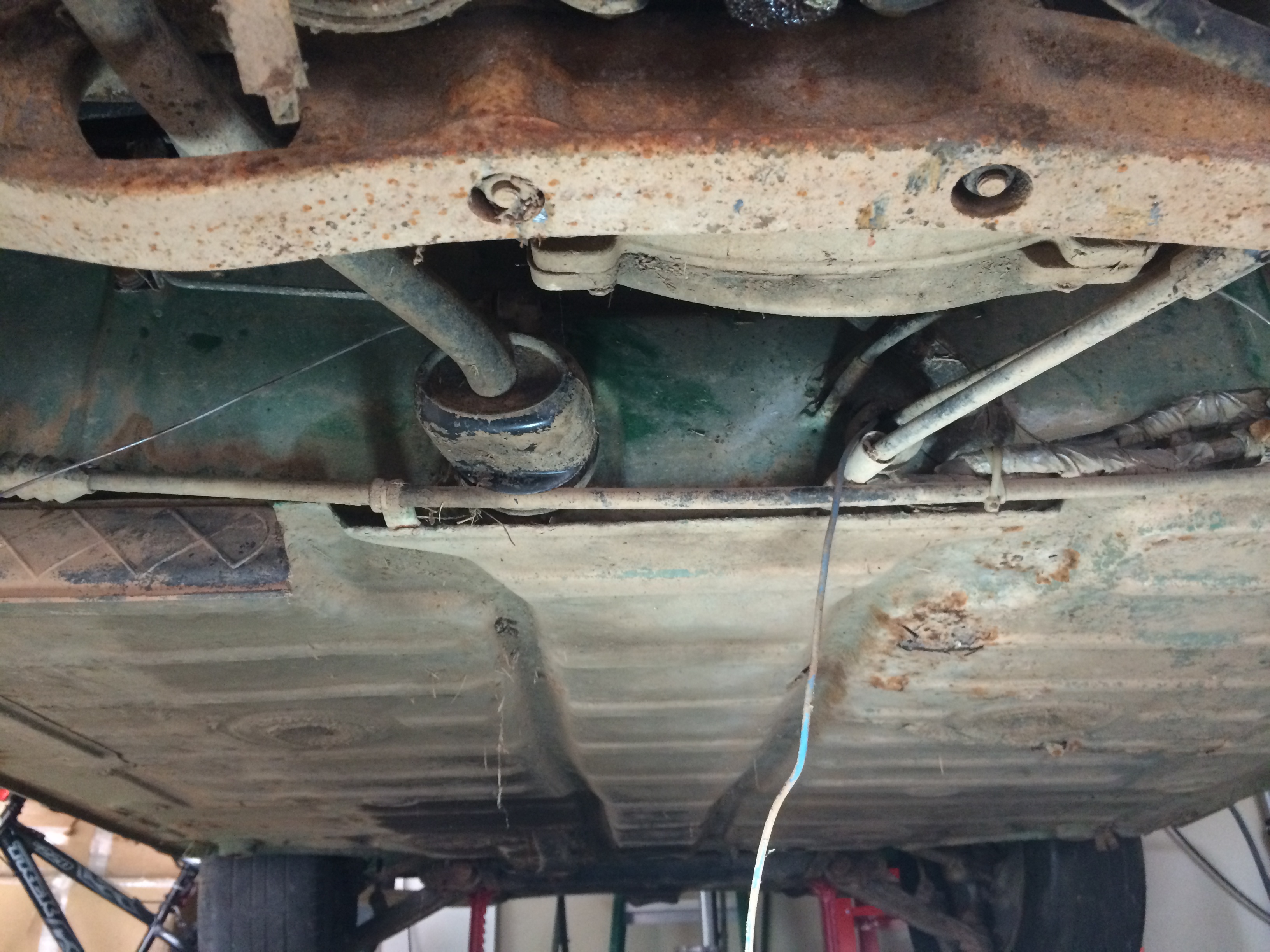

jmitro   Floor pans looking pretty crusty, especially passe...   Sep 17 2015, 10:40 AM
jmitro   Pretty dirty everywhere, indicating a long period ...   Sep 17 2015, 10:53 AM
jmitro   More dirt, rust and neglect.   Sep 17 2015, 10:57 AM

jmitro   lots of rust along the rear lower firewall   Sep 17 2015, 11:07 AM

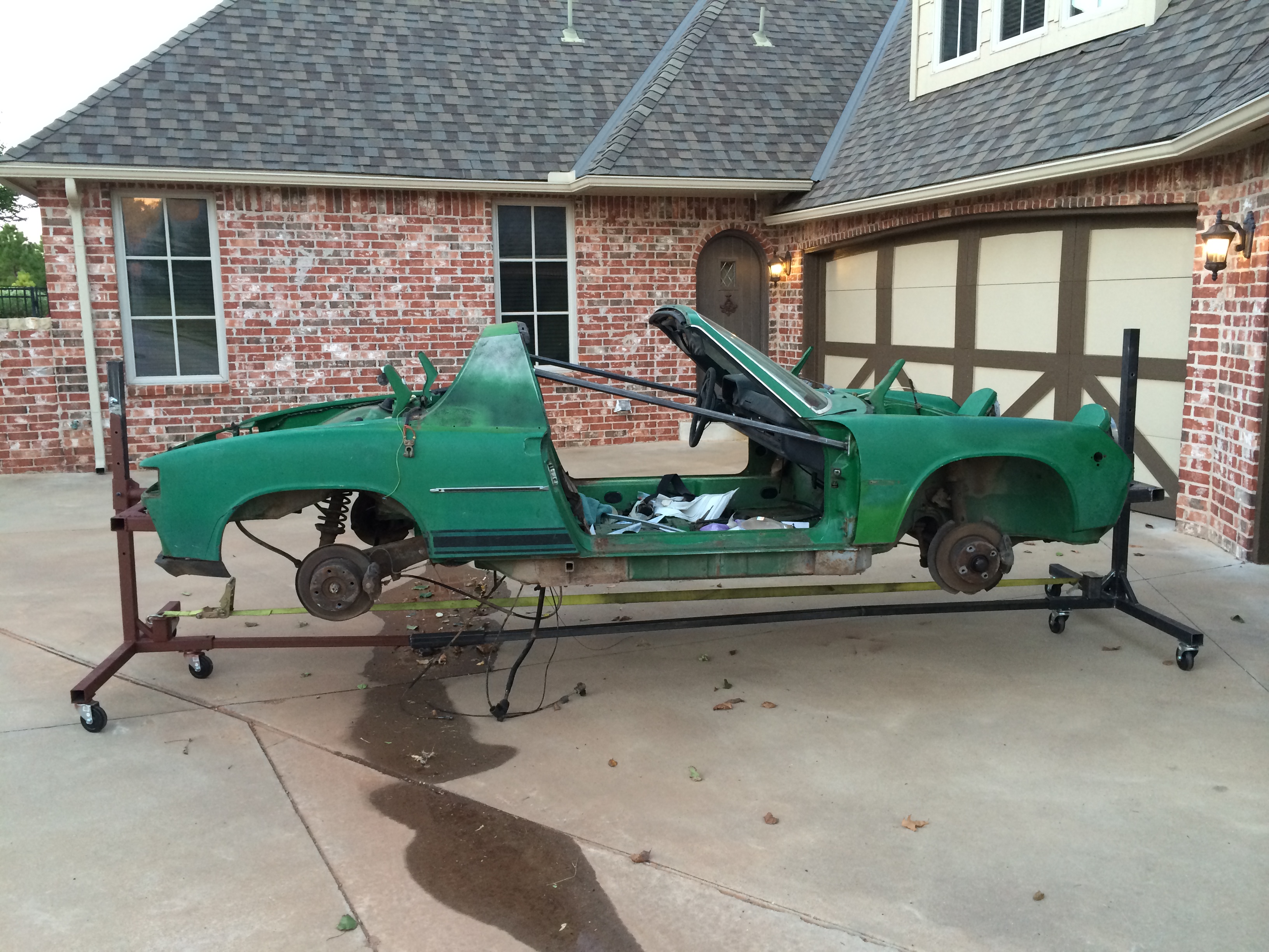

jmitro   Spent the last 4 weeks fabricating my own rotisser...   Sep 17 2015, 11:41 AM

jmitro   Rotisserie finally completed and the car can be ro...   Oct 9 2015, 10:00 PM
