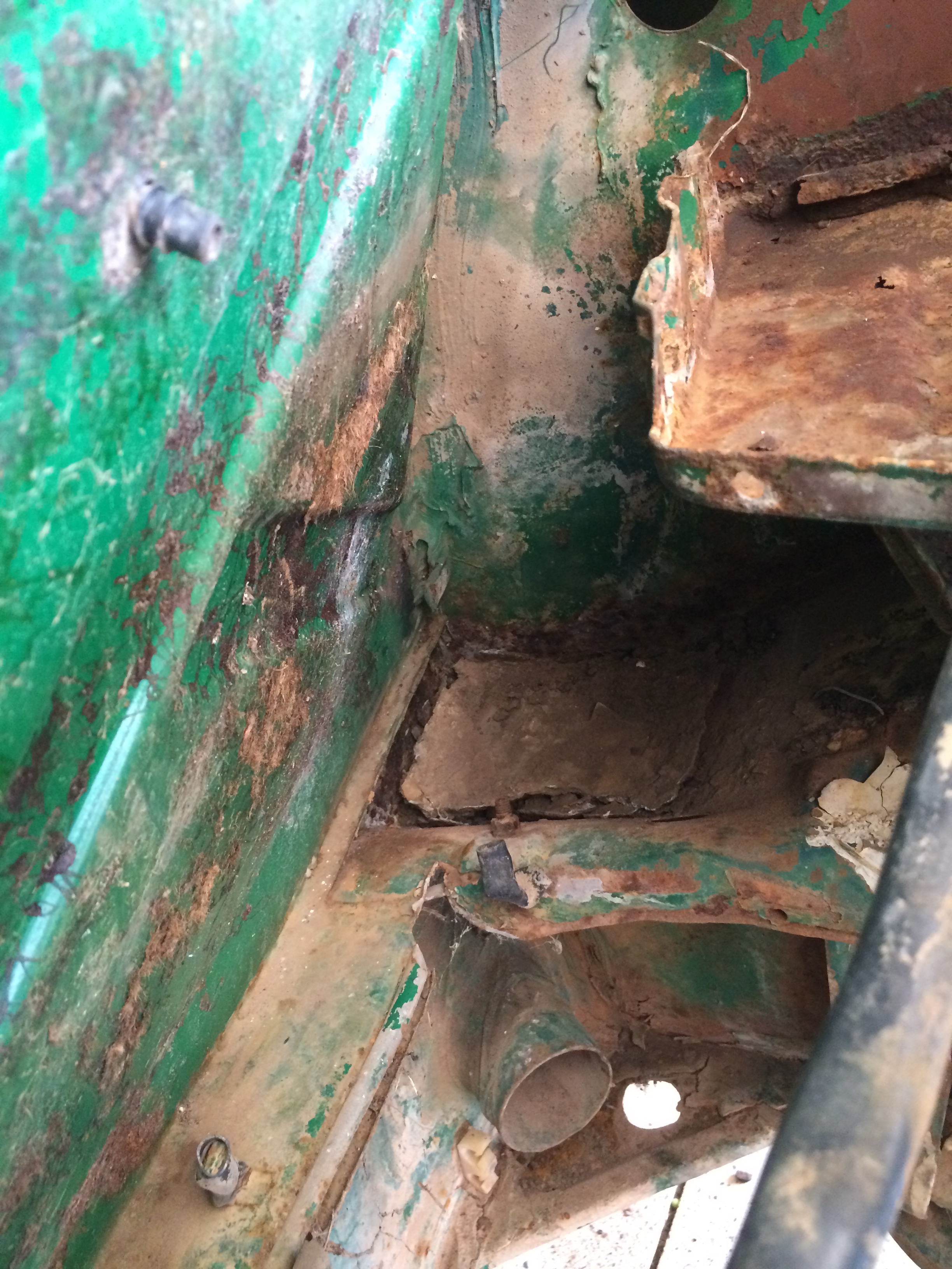

Hell hole will need some thorough inspection and probably a lot of work.

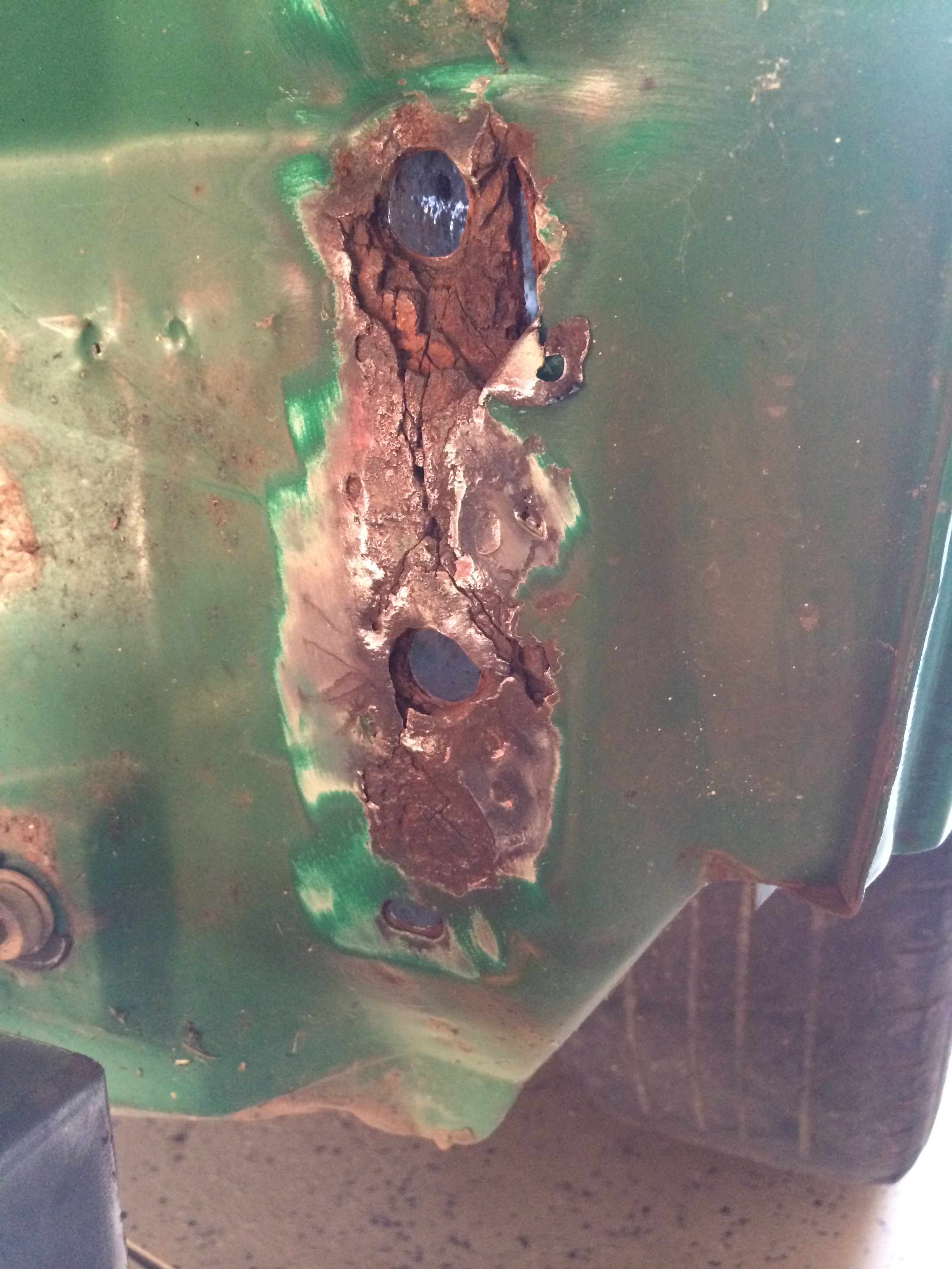

Front bumper mounts are rusty; sheetmetal attached to them has rusted through and will need to be cut out and patched at least.

jmitro   Hell hole will need some thorough inspection and p...   Sep 17 2015, 11:17 AM

jmitro   Passenger front fender had a rust hole at the bott...   Oct 9 2015, 10:06 PM
