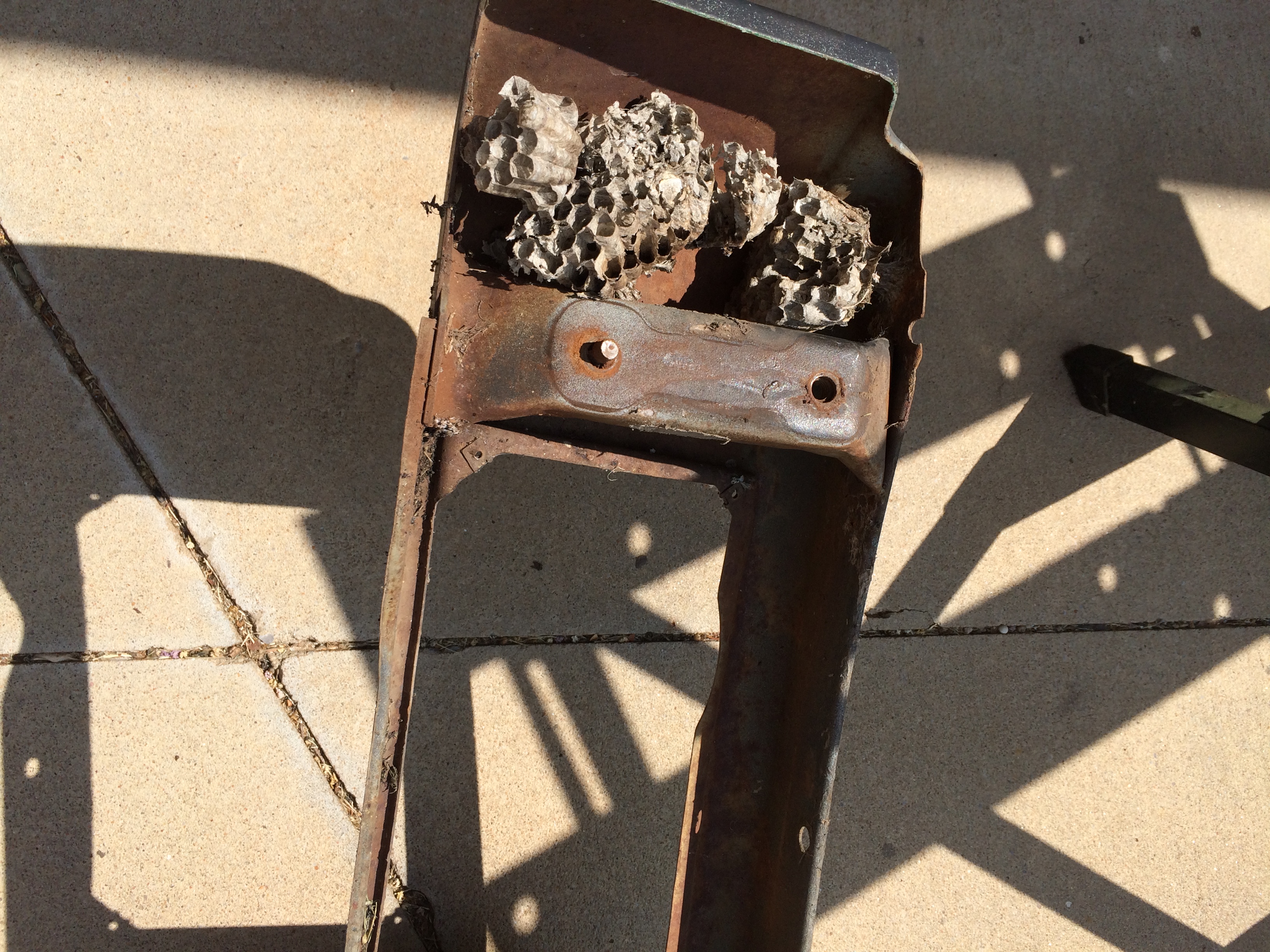

found a dead rat and lots of hornets nests; I won't post a photo of the rat like socalandy did LOL (IMG:style_emoticons/default/beerchug.gif)
