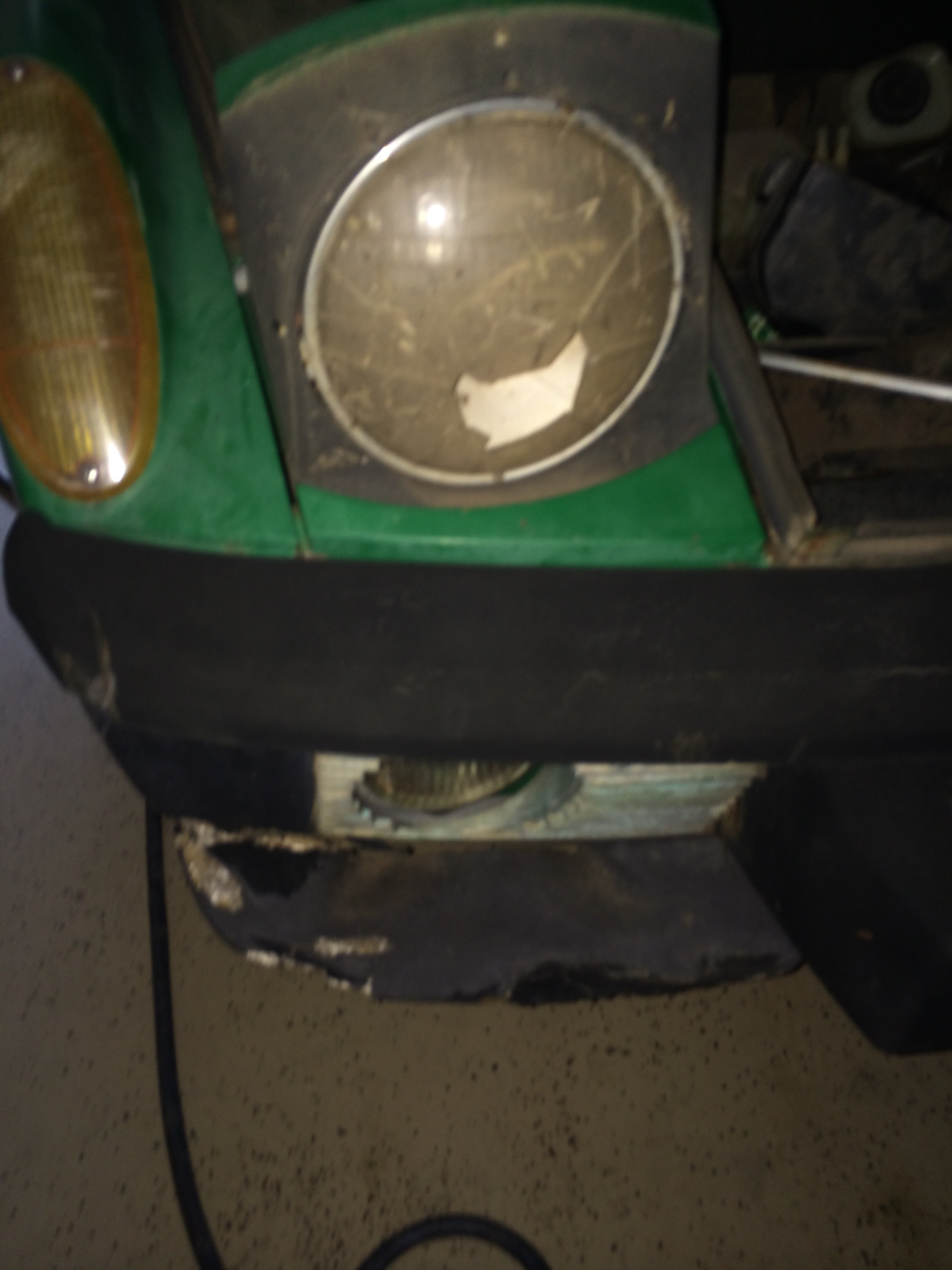

Broken headlight lens and Lots of really crusty rubber. Fiberglass bumper dam is so severely damaged it probably cannot be saved. Foglights appear to be in good shape, however.
