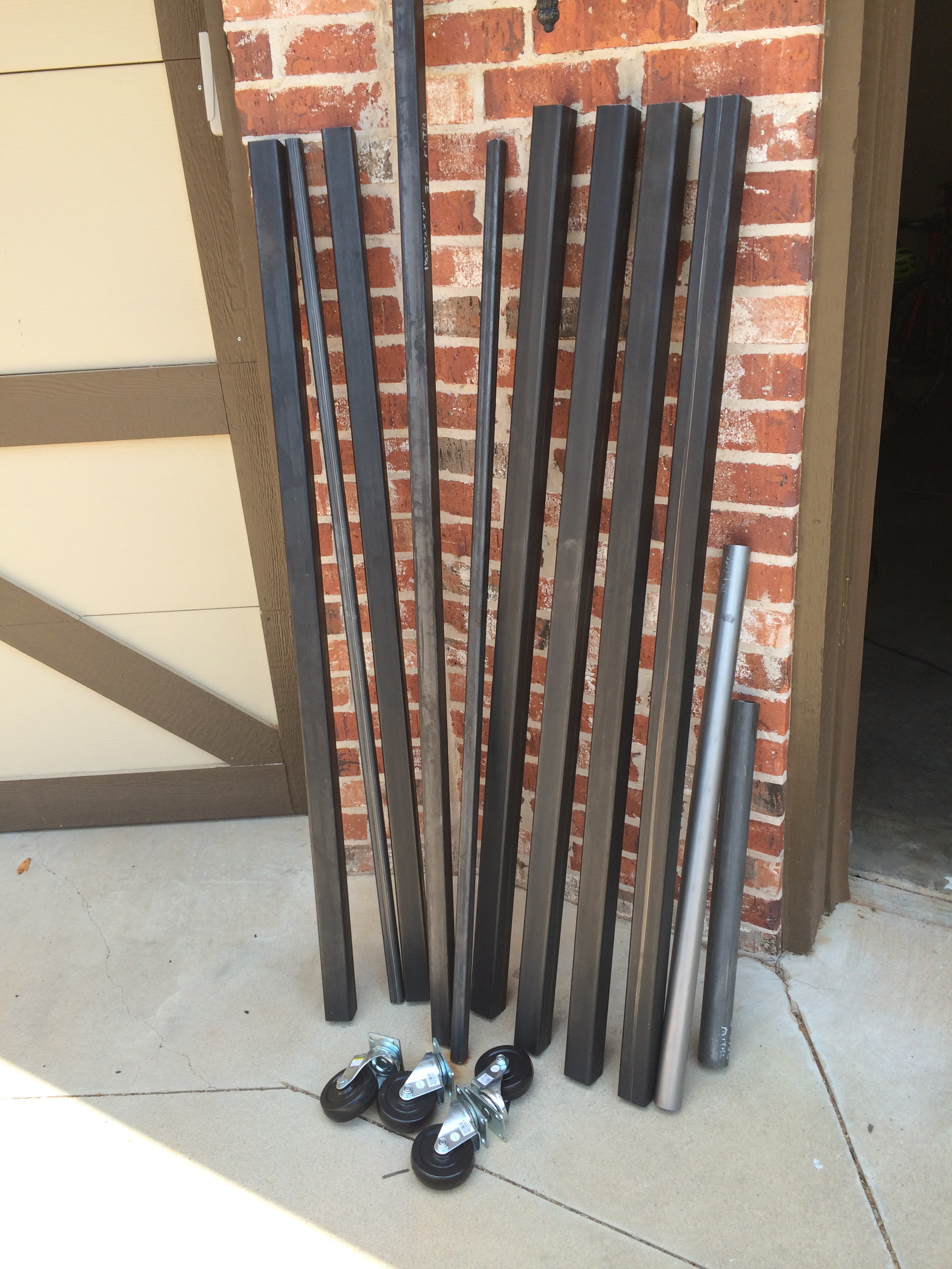

jmitro   Spent the last 4 weeks fabricating my own rotisser...   Sep 17 2015, 11:41 AM
