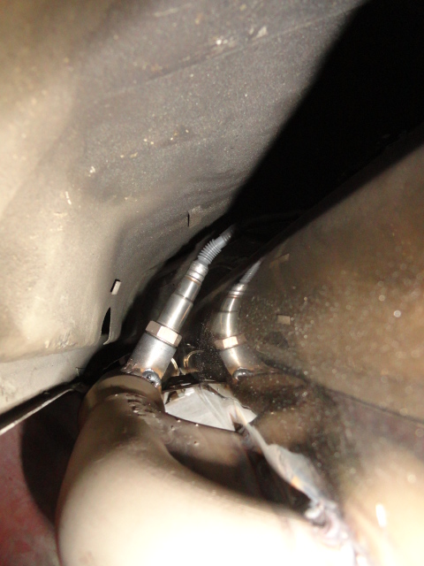

Oops! I didn't take a photo of it out of the car. I only have this one of the O2 bung/sensor I added just after the 2 exit pipes merge into one. We got a really pretty good sniff from there.
