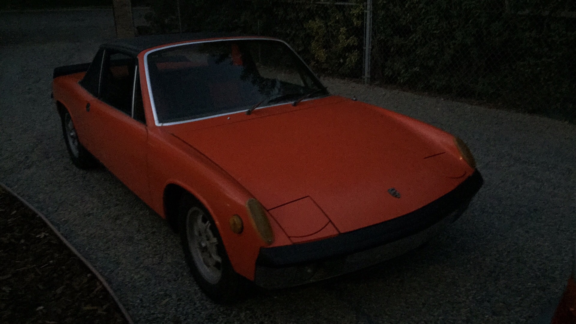

Thought I'd update the thread
After a crap ton of work this little guy is back on the road, (IMG:style_emoticons/default/driving.gif) to work tomorrow
Terrible pic more to come
