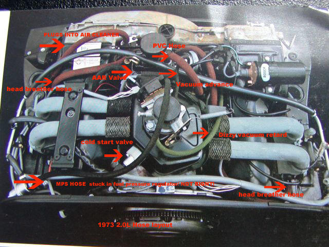

hello, patrick a. here. just accquired a 1974 1.8l 914-4 and i have a good bit of work to do to make this vehicle in any sort of shape to go long distance cruisin/autocrossing. various electrical gremlins/nasty old rubber fuel lines and a lot of general tune up needs to be taken care of. im having trouble figuring out where some loose vacuum lines are to be routed. this first picture shows some vacuum valve that i believe is routed to that evap. can that looks like a tiny muffler and has a cut line that im not sure where to put:

Here's a pic that might help you out.

2-OH!   If it really is a 2.0, then the port on the back o...   Sep 17 2004, 08:32 PM

Jeff Bowlsby   By the boot in your photo, your wiring harness is ...   Sep 17 2004, 10:12 PM
SpecialK   Here ya go! http://www.pelicanparts.com/914/t...   Sep 17 2004, 10:17 PM

monkei   thanks for the pic and the link! i should be a...   Sep 19 2004, 12:30 AM
monkei   both the picture and the PP diagram dont show a ch...   Sep 19 2004, 12:36 AM

monkei   my 2.0 has the single vacuum port on the throttle ...   Sep 19 2004, 04:39 PM
2-OH!   Monkei: I have found the Pelican diagram to be......   Sep 20 2004, 07:56 AM
monkei   i totally empathize with it being hard to describe...   Sep 20 2004, 05:48 PM
