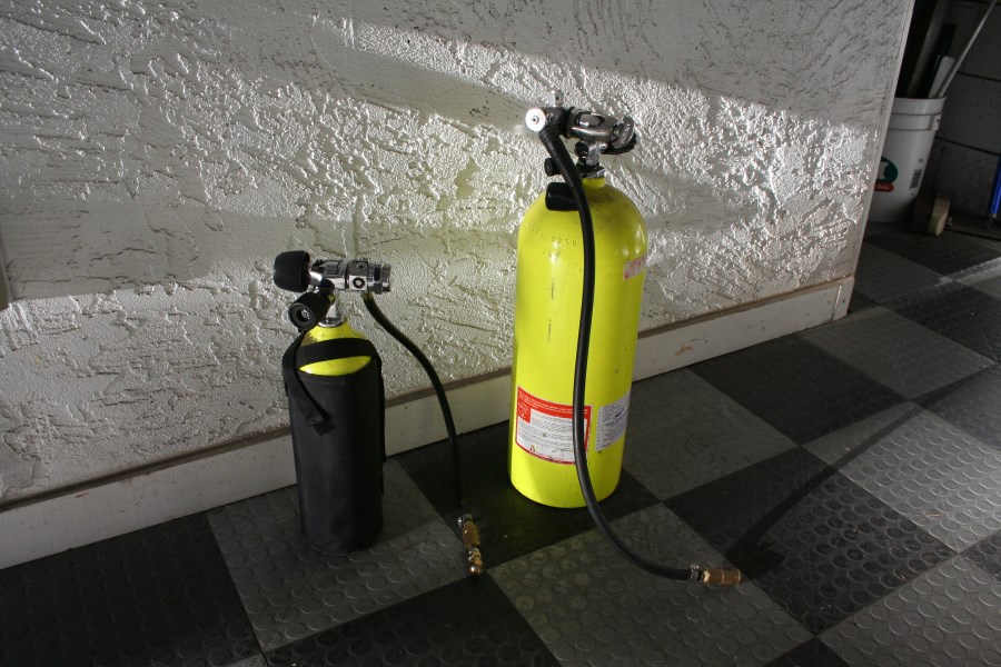

I use a small SCUBA pony bottle for a compressed air source with the first stage of an old SCUBA regulator. The first stage reduces the pressure to a usable 120 PSI. The only drawback is, you must be SCUBA certified to have the tank re-filled and it must be visually inspected and pressure tested on a regular basis.
