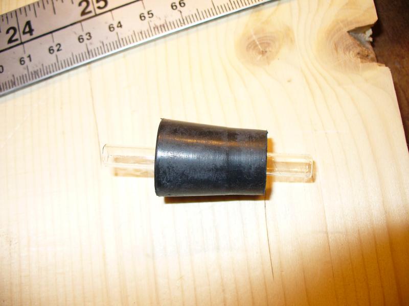

Whenever I bolt the heat exchangers to a motor, I check to see if they hold air by putting each cylinder to tdc and blowing into the muffler end of each port. I use a rubber stopper with an aluminum tube through it - something I made, looks like this, kind of.
(IMG:http://www.914world.com/bbs2/uploads_offsite/media.offbeatempire.com-11782-1443219910.1.jpg)
This is also a good test to see if the exhaust is sealing at the head, which can be a problem, and can be done with the boxes on the car, just gotta take off the muffler.
