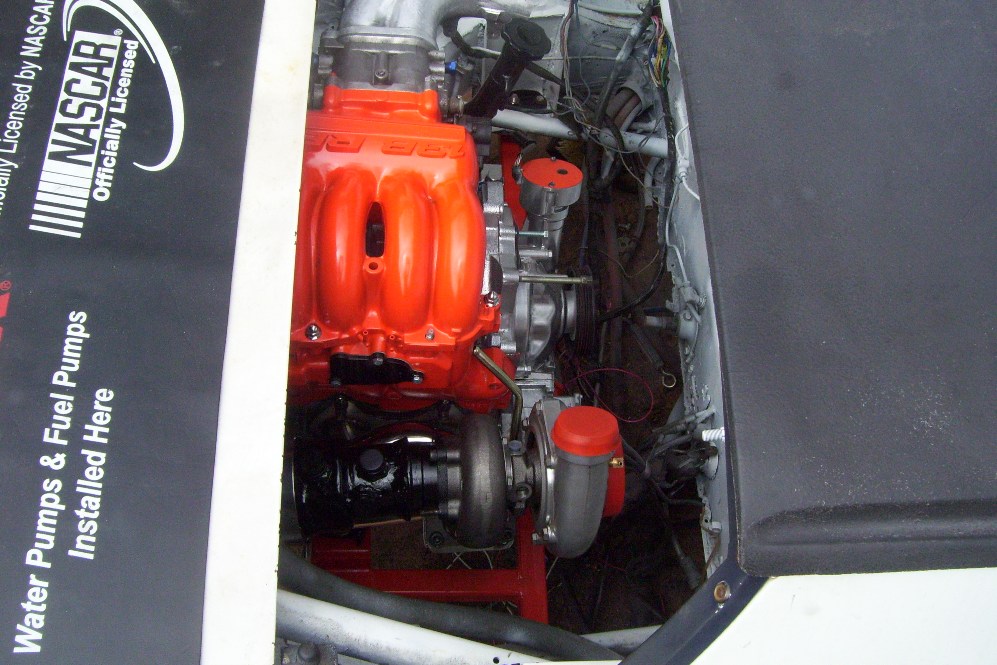

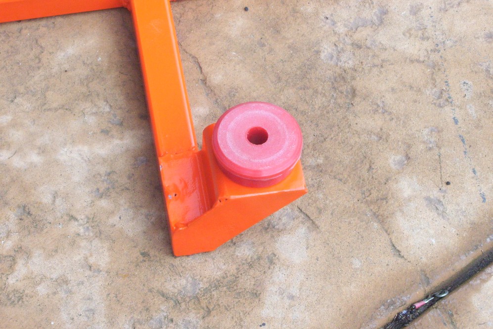

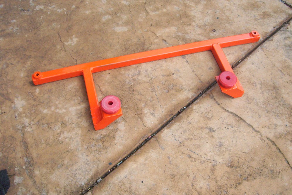

I'm worried about your engine mount. My rotary mount was very similar and started to sag after a couple months of driving. My new cradle ties the front to the rear so no sagging is possible.
R_u_dd
post Sep 27 2015, 08:16 PM
Posts: 154
Joined: 3-March 14
From: Grants Pass, Oregon
Member No.: 17,072
QUOTE(Mike Bellis @ Sep 27 2015, 06:36 PM) *
The factory bracket bar is very heavy. Feels pretty stout to me. Did you build yours like I did? What page is it on in your thread?
Mike Bellis
post Sep 27 2015, 08:33 PM
Resident Electrician
Posts: 8,348
Joined: 22-June 09
From: Midlothian TX
Member No.: 10,496
QUOTE(R_u_dd @ Sep 27 2015, 07:16 PM) *
Here is my rotary build thread. http://www.914world.com/bbs2/index.php?showtopic=113156
Although not exactly the same, the forces applied to the square bar are the same. My bar is made from 1.5", 0.120 wall square tubing. The rotary engine is also lighter than a Subie. The rear mounts sagged a full inch. Yours may not sag as much but the twist force is similar on the main bar. V8 motors are heavier but the angled motor mount bars lean toward the main bar mounts sending more load to the 914 mounting point and not the center of the main bar.
