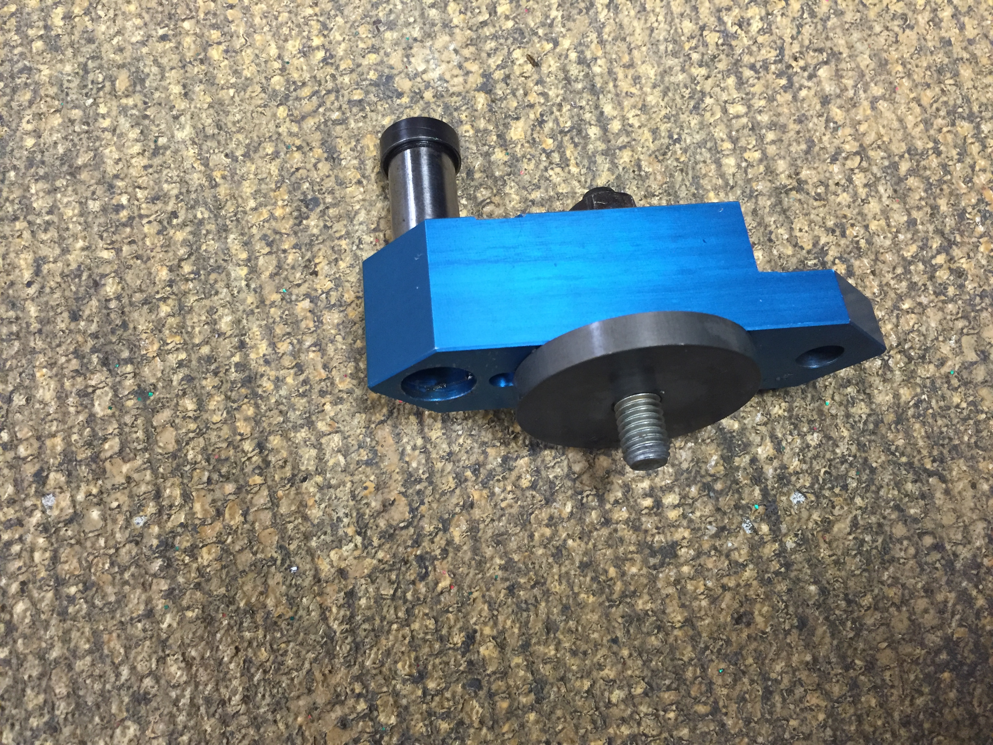

saigon71   Thanks for all the advice and suggestions – I gr...   Jan 31 2015, 05:06 PM
saigon71   Made three different fixtures so I could step dril...   Jan 31 2015, 05:31 PM

saigon71   I am very happy to report that it worked well. Us...   Jan 31 2015, 05:47 PM
