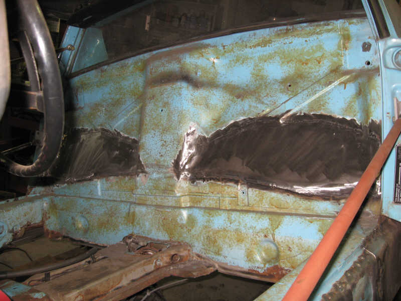

Olympic 1.7   Next a couple pictures of the rust. I knew it was...   Oct 2 2015, 07:12 AM

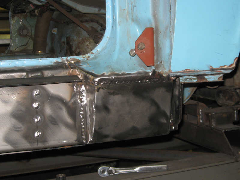

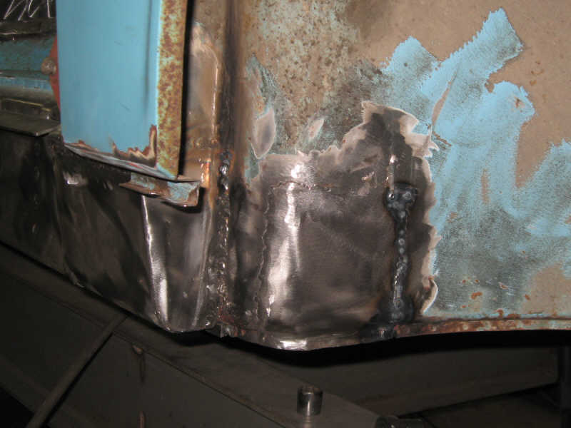

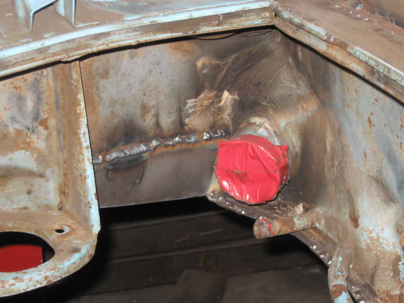

Olympic 1.7   This is the work that was completed by the guys at...   Oct 3 2015, 10:14 AM
Olympic 1.7   Couple more   Oct 3 2015, 10:17 AM
Olympic 1.7   While Tangerine was working on the body I started ...   Oct 3 2015, 10:37 AM
dangerranger01   Curious on what kind of long stiffening Tangerine ...   Oct 4 2015, 08:08 PM
Olympic 1.7   Curious on what kind of long stiffening Tangerine...   Oct 5 2015, 09:53 AM
mbseto   Curious on what kind of long stiffening Tangerine...   Oct 5 2015, 07:30 AM
Racer Chris   Those are the 914LTD long stiffening kit.   Oct 5 2015, 10:40 AM
914forme   And I will Say the 914LTD log kit is a great item....   Oct 5 2015, 11:09 AM
