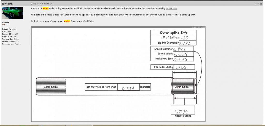

sawtooths axles
>> has anyone used this dimension with a coldwater cradle ??

QUOTE(jimkelly @ Oct 3 2015, 05:12 AM) *
sawtooths axles
Your getting way ahead of yourself. You'll need to measure those once your drive train is in. These cars vary dimensionally. Don't be surprised if there is a 2-10mm difference between sides. You will want these cut as long as possible. They should just barely squeeze in to place with very little room to spare. BTW, when do you plan to start working on the conversion?

post Oct 3 2015, 10:24 AM
Delaware USA
Posts: 4,969
Joined: 5-August 04
From: Delaware, USA
Member No.: 2,460
your conversion was epic - others can see it here.
http://www.914world.com/bbs2/index.php?sho...hl=subaru++tool
mine will be primarily a bolt in affair. mine will only be of some interest to those that have my very limited skill set. sorry (IMG:style_emoticons/default/sad.gif)
thanks though regarding your comments related to axles. (IMG:style_emoticons/default/shades.gif)
I am trying to find anyone who is using a coldwater cradle and a 914 cv at wheel and suby cv at trans. cause we should all be in same boat.
jim
