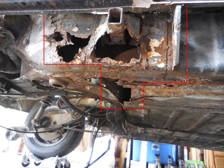

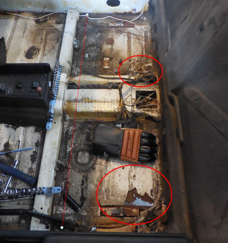

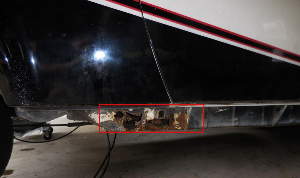

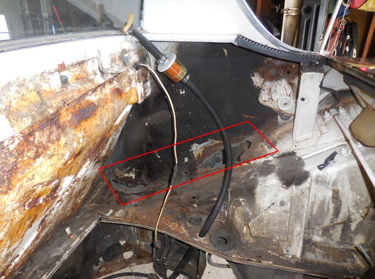

Rust Update.
While im waiting for chassis braces to arrive, here are some photos of the rust that that I have to tackle. My plan of attack is to cut along the red lines with a grinder, but my friend mentioned that it may be beneficial to cut rounded. I have no welding experience so any feedback would be welcomed.
My plan parts list is as follows:
Rear floor pan
Right Rocker Panel
inner longitude member passenger side
Is there anything else I am missing?

mepstein   Once you start removing paint, floor tar and under...   Oct 4 2015, 03:21 PM
brettrarnold   Once you start removing paint, floor tar and unde...   Oct 4 2015, 04:02 PM
stevegm   After you cut out all of the rust, make sure you t...   Oct 4 2015, 04:18 PM
