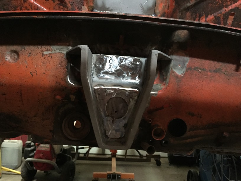

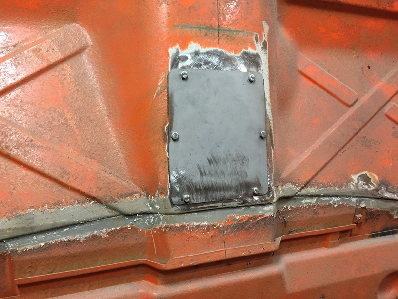

I fabricated an engine mount that was as close to the original as possible and then welded it in.

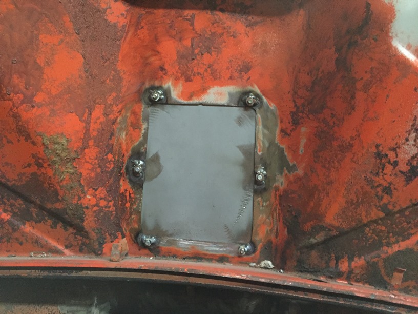

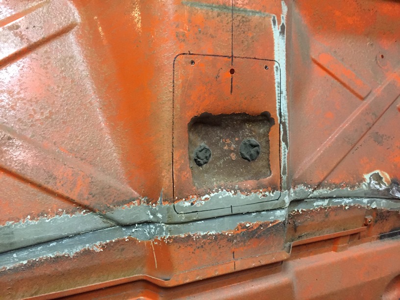

Somewhere along my cars history a PO modified the firewall for some reason.
I decided that the best option was to cut the area out and put a plate over it so that I can service the 6 cylinder that will be going in the car.
The top of the hole is 5.25 wide and the bottom of the hole is 5.62 wide. It hole is 6.75 high and the bottom edge of the hole is 10.12 up from the top of the center tunnel.

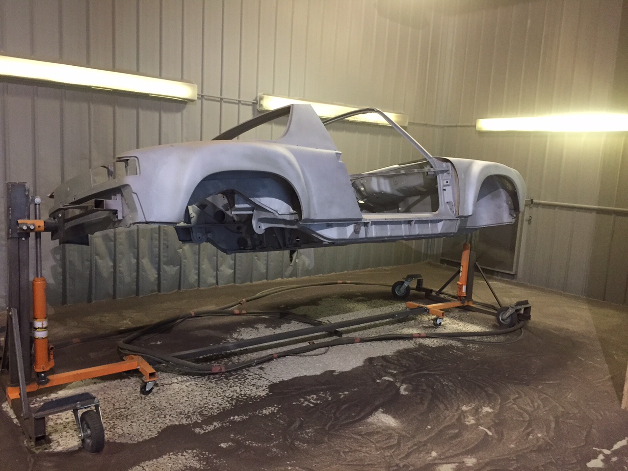

This weekend my granddaughter stayed with us and she helped me clean up the garage and get the car ready to go to the media blaster.

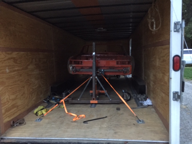

My son let me borrow a car hauler and we loaded the car up on the rotisserie.
The car looks great after it was media blasted and then we dropped it off at the painter.
Now I just have to wait for it to get painted which from past experience may be a lot longer that what the painter estimates. I hope he gets it done since I have a lot of assembly time to get this done in time for the 914 Build Challenge!
