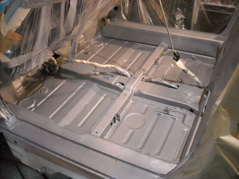

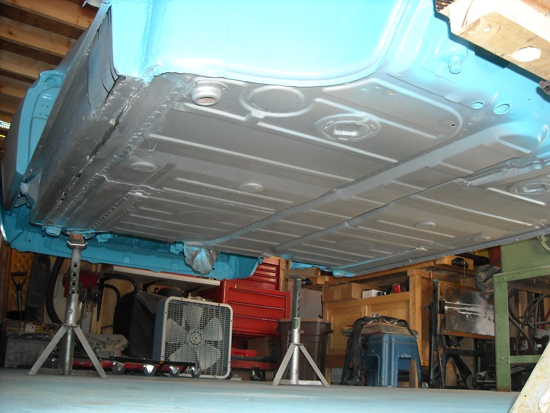

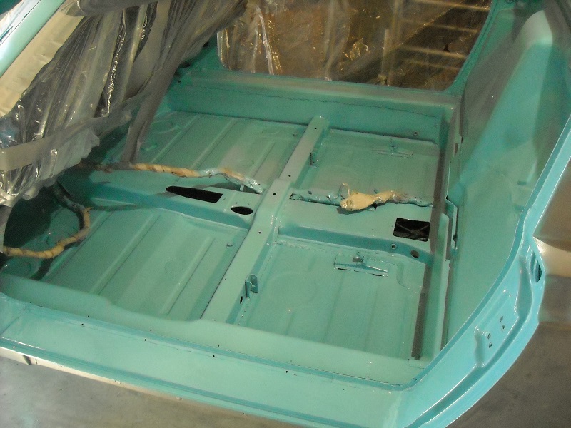

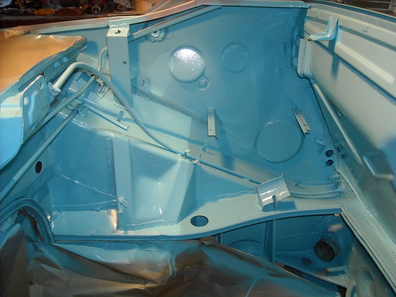

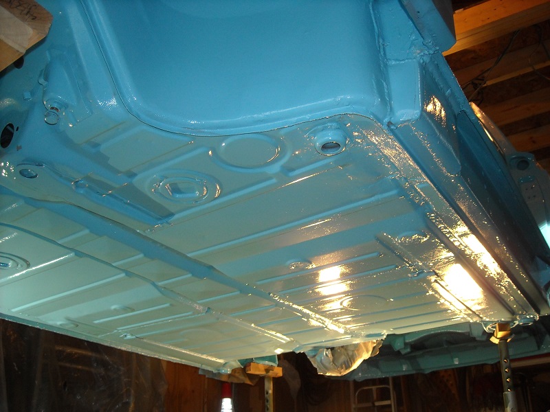

Got some more paint on it. finished the undersides. Everything no one will see. Just trying to get good with a spray gun.
all the undersides, inner fenders, under the trunks etc. got two coats of Rust Bullet. I like this stuff because it is hard as a rock. I didn't put it on any rusty metal like they say you can though. I blasted and sanded everything first. the two coats go on about 2-4 hours apart then the next day I would hit it with two coats of epoxy primer and two coats of urethane. I used PPG paint for the epoxy and PPG JAU for the color.
Same for the interior and engine compartment. all these surfaces have 6 coats of paint on them now.
Just got the underside of the pan and the engine compartment finished in epoxy and color today. I still have to reshoot the rear trunk because I burned up the paint there welding in the rear sway bar mounts.
What a pain lying on your back spraying with the car literally 12 inches from your face. The rotisserie would be REALLY nice....
Guess I have to start working on the fenders again..
