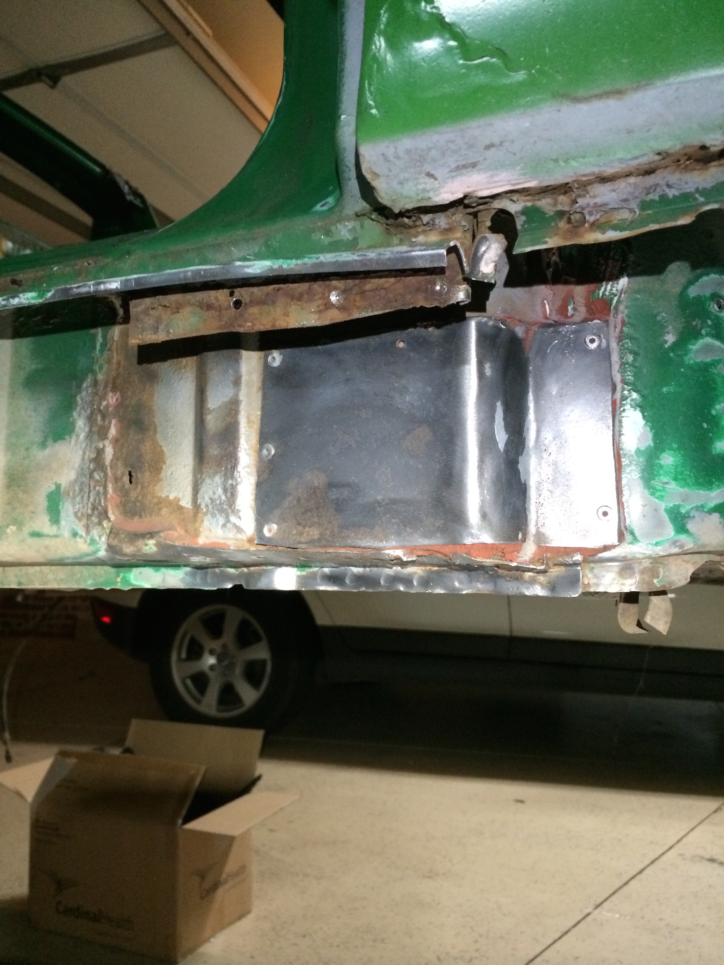

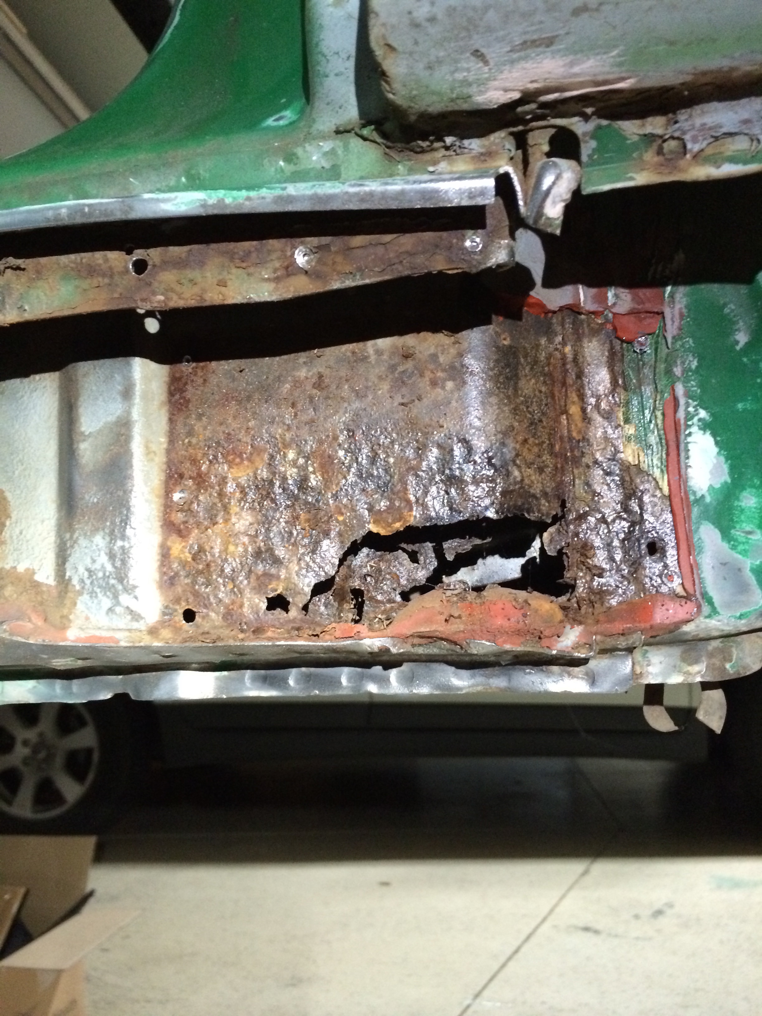

Like I Previously mentioned, the PO had some creative methods of hiding rust with some stock sheetmetal. This piece was riveted to the outer long sheetmetal. After removing it, look what was underneath:
