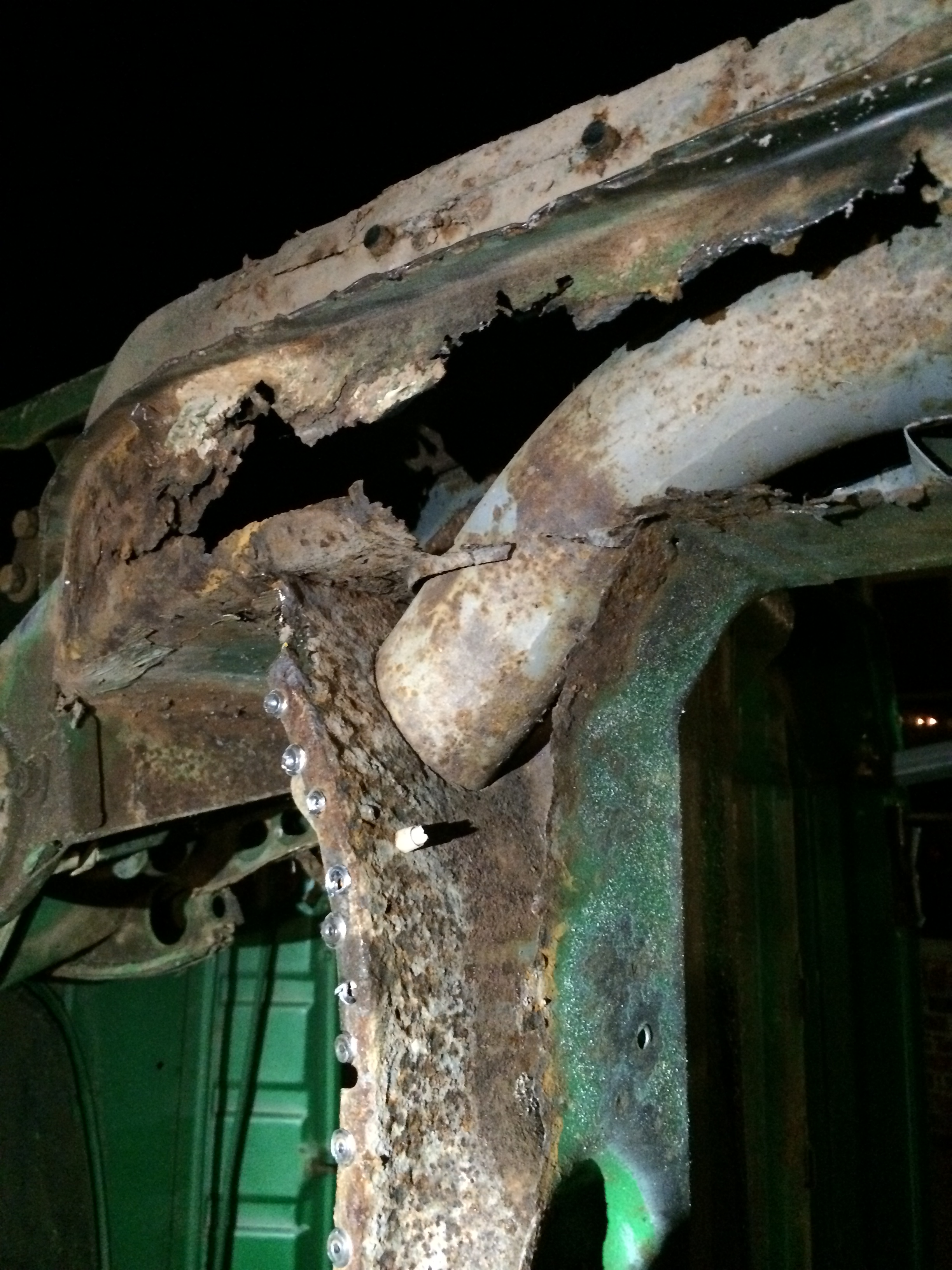

Rocker cover removed to reveal the underlying cancer in the hellhole. This is going to take a lot of work

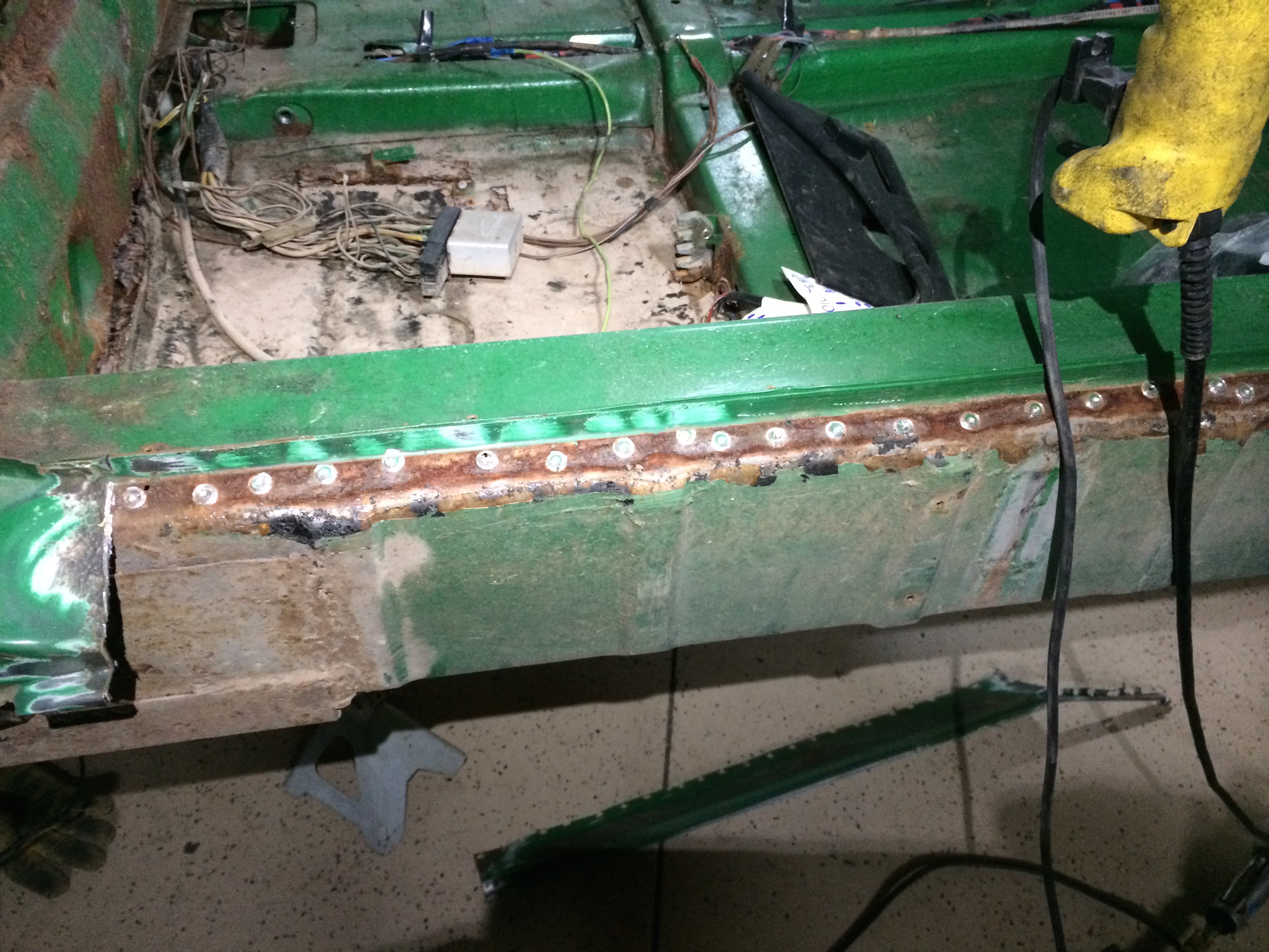

Removed the rotten passenger side rear floorpan. Yuck!!
