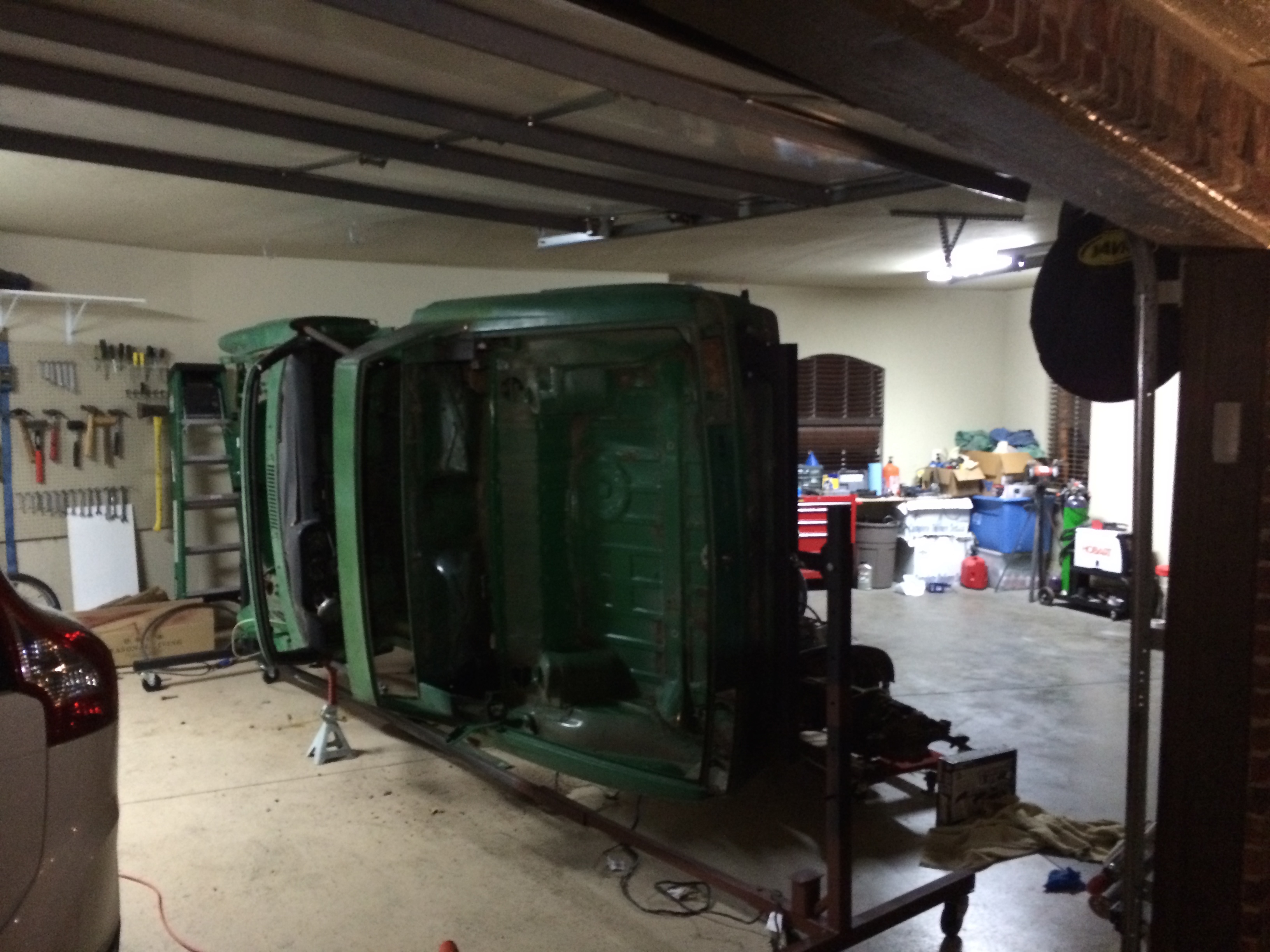

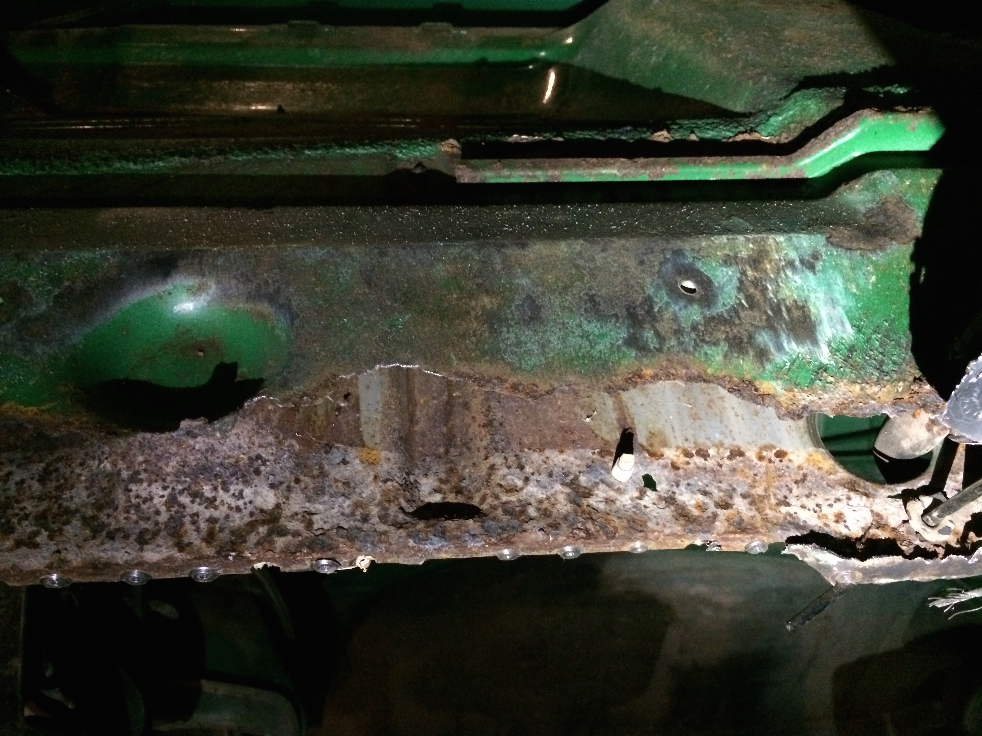

Rotisserie finally completed and the car can be rotated 360 degrees. For now it's on the side so I can access the floorpans and hellhole.
with the passenger rear floorpan cut out, you can see just how rotten the bottom edge of the firewall really is. I'll cut this out and graft in some fresh metal.
