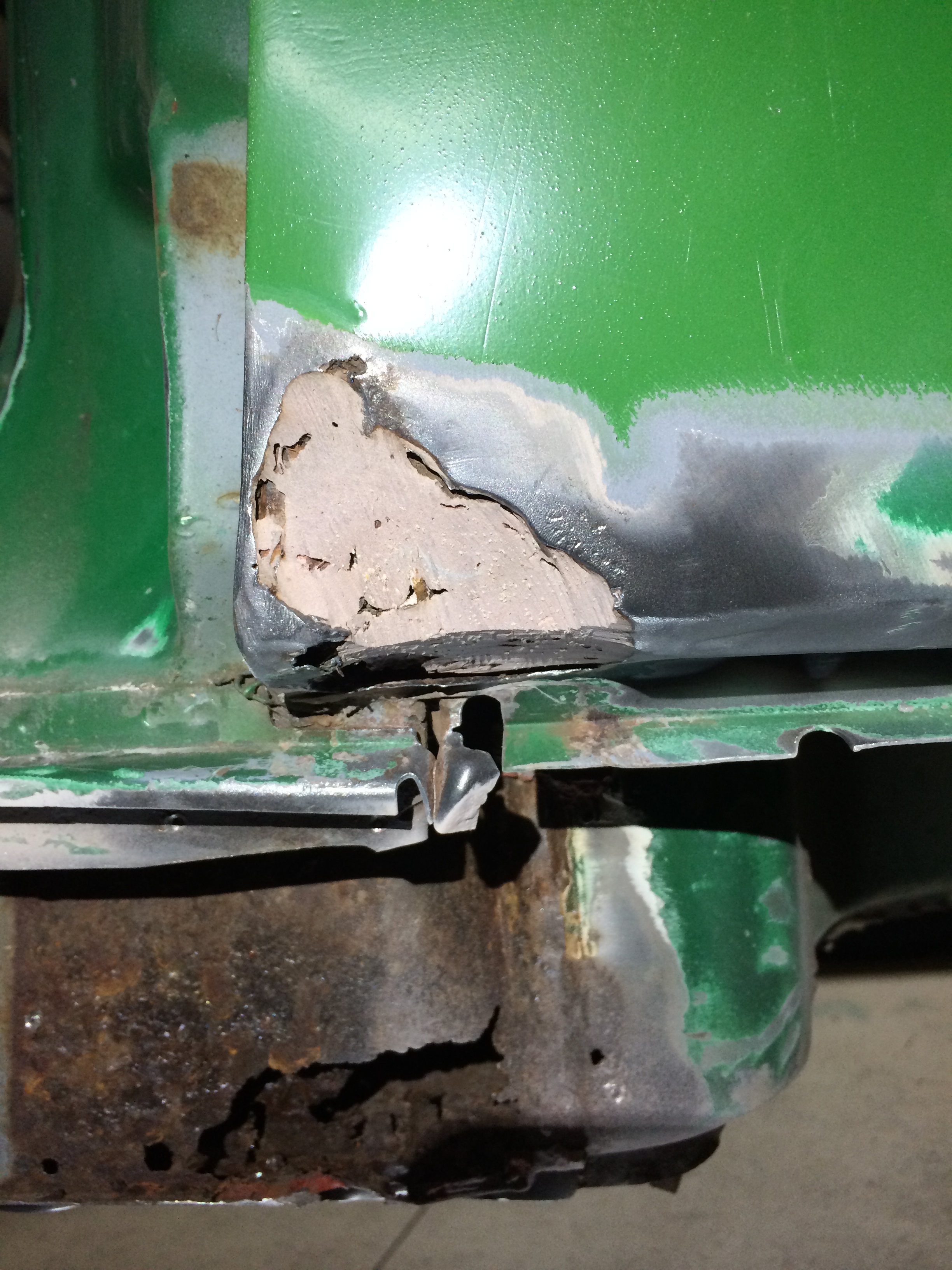

Passenger front fender had a rust hole at the bottom corner that was filled with literally gobs of bondo. Haha. Another patch to be done.....
