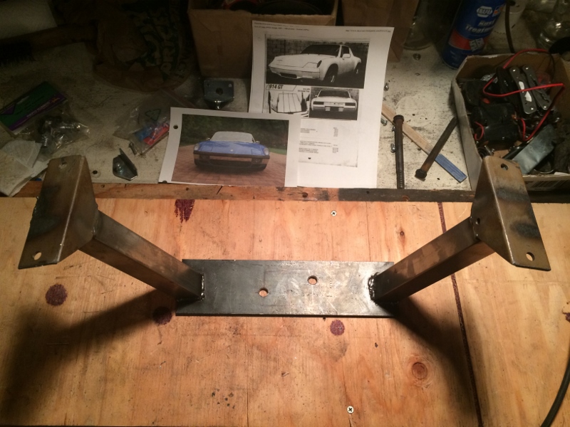

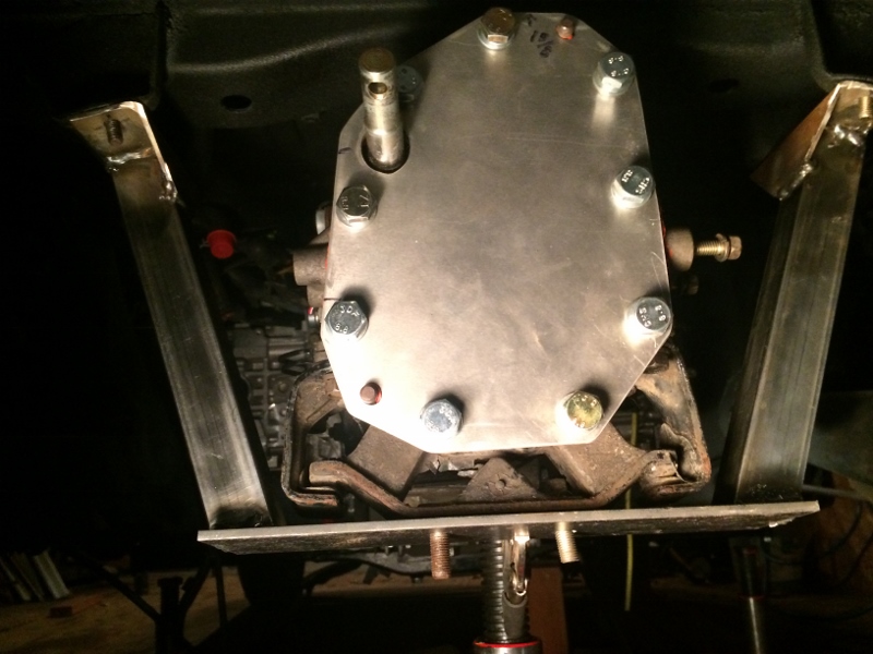

Transmission Mount
From the Subaru 5MT Transmission out of a 2002 Impreza TS, I saved the transmission mount and integrated into the design to mount onto the Porsche. The rubber stoppers are stout and will prevent vibration. It was also easier to fabricate than using the circular Porsche mounts. I deliberated whether to use the circular mounts because they seem to provide a full range of motion to the transmission, but I was concerned there might be too much flex. In the end I went with the Subaru mount which also allows some movement front to back and up and down.
(IMG:http://www.914world.com/bbs2/uploads_offsite/i1301.photobucket.com-17072-1444502917.1.jpg)
(IMG:http://www.914world.com/bbs2/uploads_offsite/i1301.photobucket.com-17072-1444502917.2.jpg)
