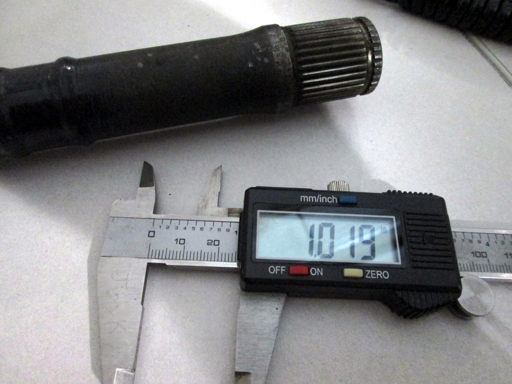

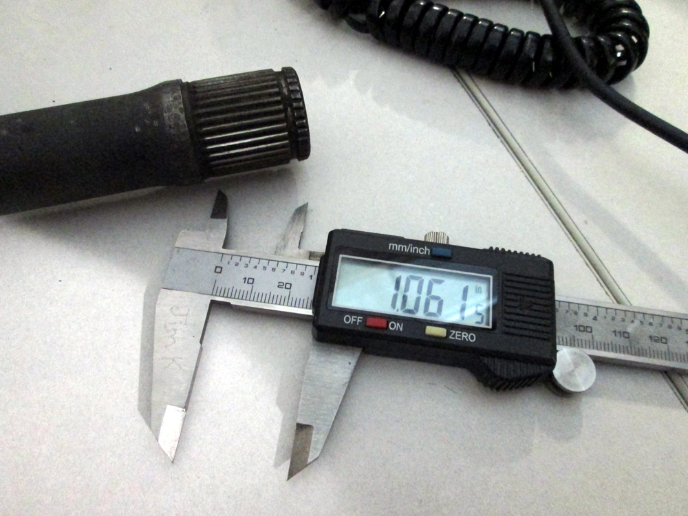

OD of splined end of stock 914 axle is 1.066.
what i am confused about in sawtooth's machining drawing is that the end with all the measurements looks like the 914 end that should have remained untouched i thought. is the CV ID of a suby larger or smaller than the CV ID of a 914 stock cv. i assume smaller otherwise how else could a stock 914 axles be machined to accept a suby cv ????

QUOTE(jimkelly @ Oct 7 2015, 11:56 AM) *
Read right past this the first time but yes, you are correct. Plenty of meat.
