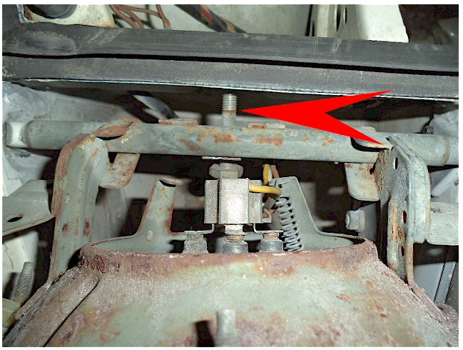

decided that I will just put a delrin spacer here to keep headlights in UP position, permanently.
the idea is less demand on electrical system and less weight. and I always drive with headlights on anyway.
rcvd my ebay fuses and a knob for my V8 car.
