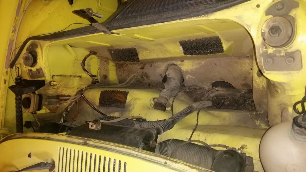

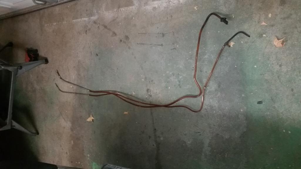

Progress from last night.
Ready for installing the new prebent lines. Going to remove the shifter and rod and the fuel line grommet up front to hopefully make the install easier. I dont anticipate it to be fun...

76-914   :popcorn: Were the OE plastic lines still good? M...   Oct 20 2015, 08:35 AM
Andyrew   Plastic lines looked good. Fabric lines were ready...   Oct 20 2015, 08:47 AM
