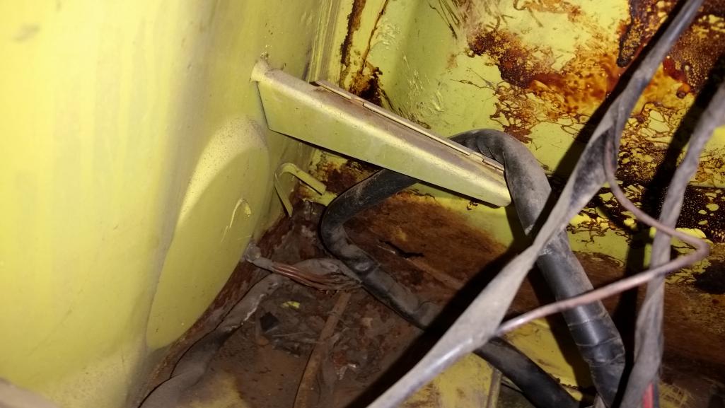

Firewall rust (IMG:style_emoticons/default/sad.gif)
The owner and I are discussing the possibility of me doing the rust repair.

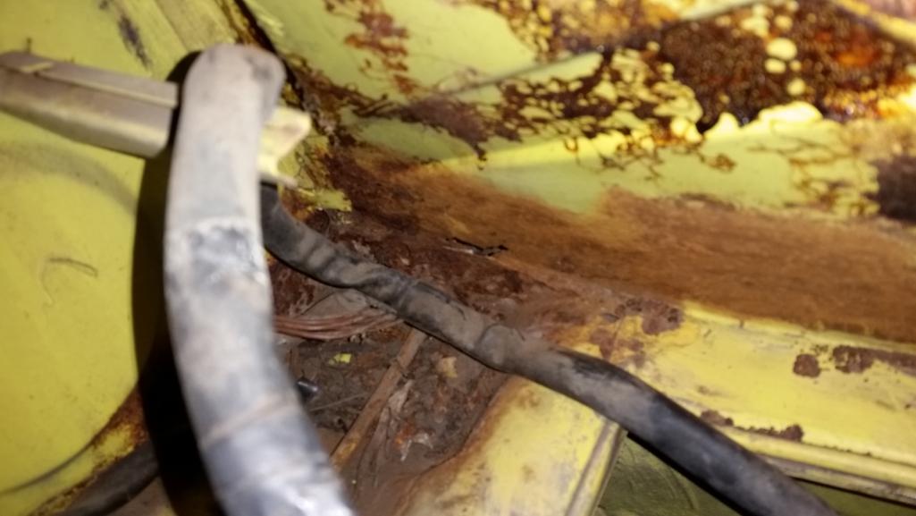

Andyrew   Firewall rust :( The owner and I are discuss...   Oct 22 2015, 11:43 AM
Andyrew   More..   Oct 22 2015, 11:48 AM

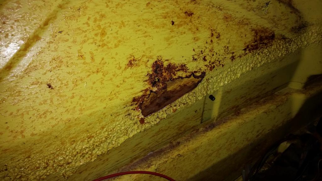

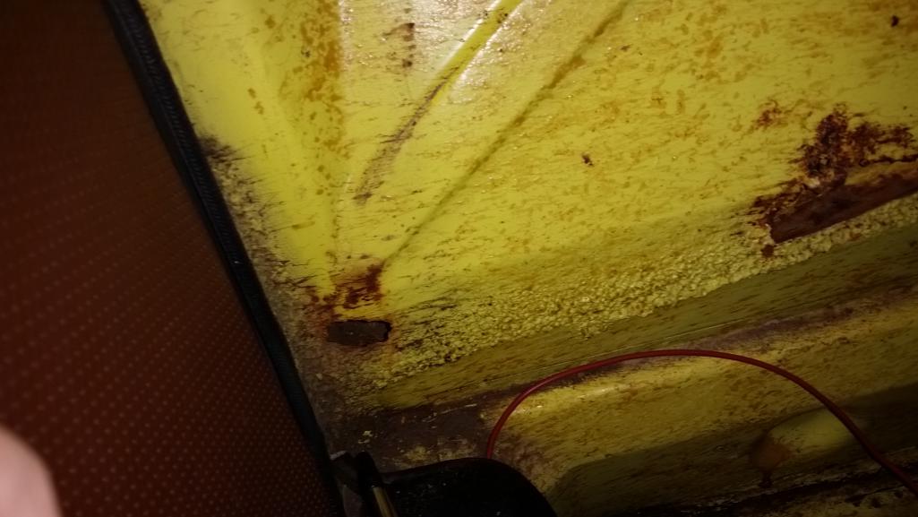

Andyrew   A bit more digging of the rust. As I anticipated i...   Oct 23 2015, 06:38 PM
matthepcat   Yikes. The owner might want to delay engine instal...   Oct 23 2015, 09:52 PM
Andyrew   The owner has agreed to have me repair the rust. I...   Oct 23 2015, 10:05 PM
