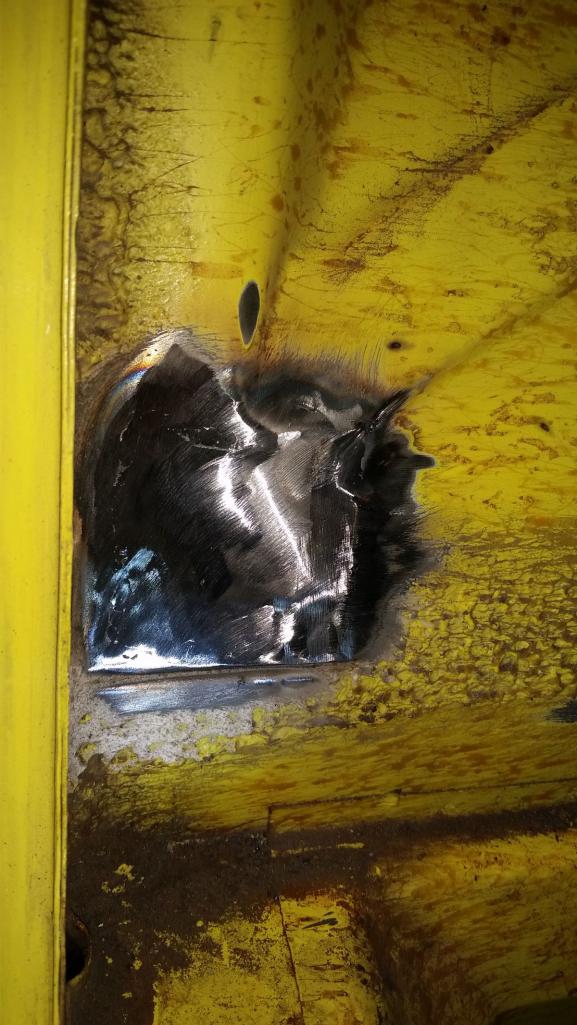

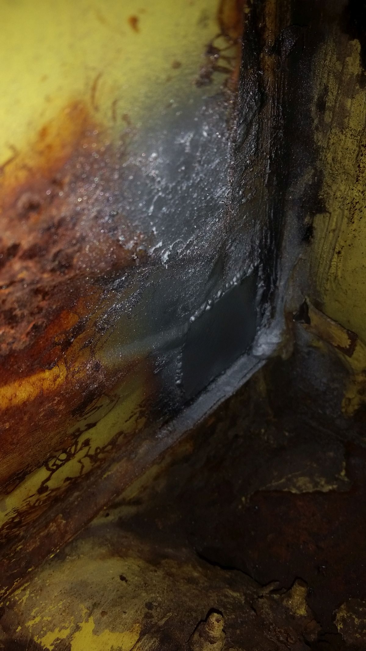

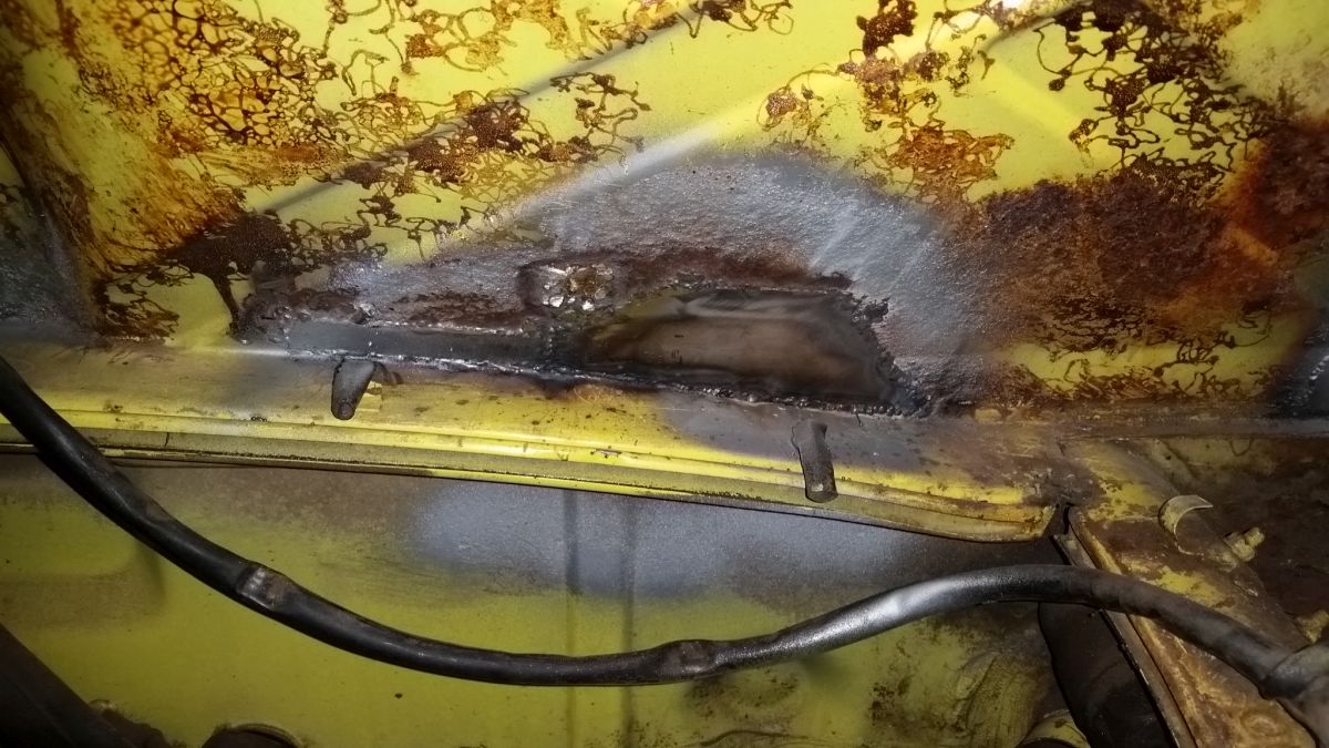

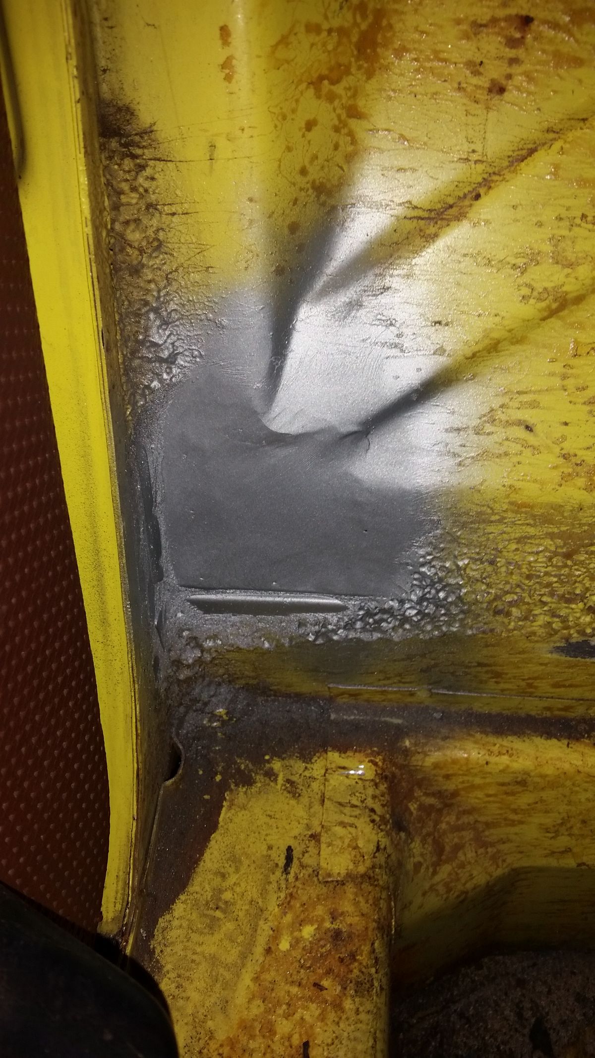

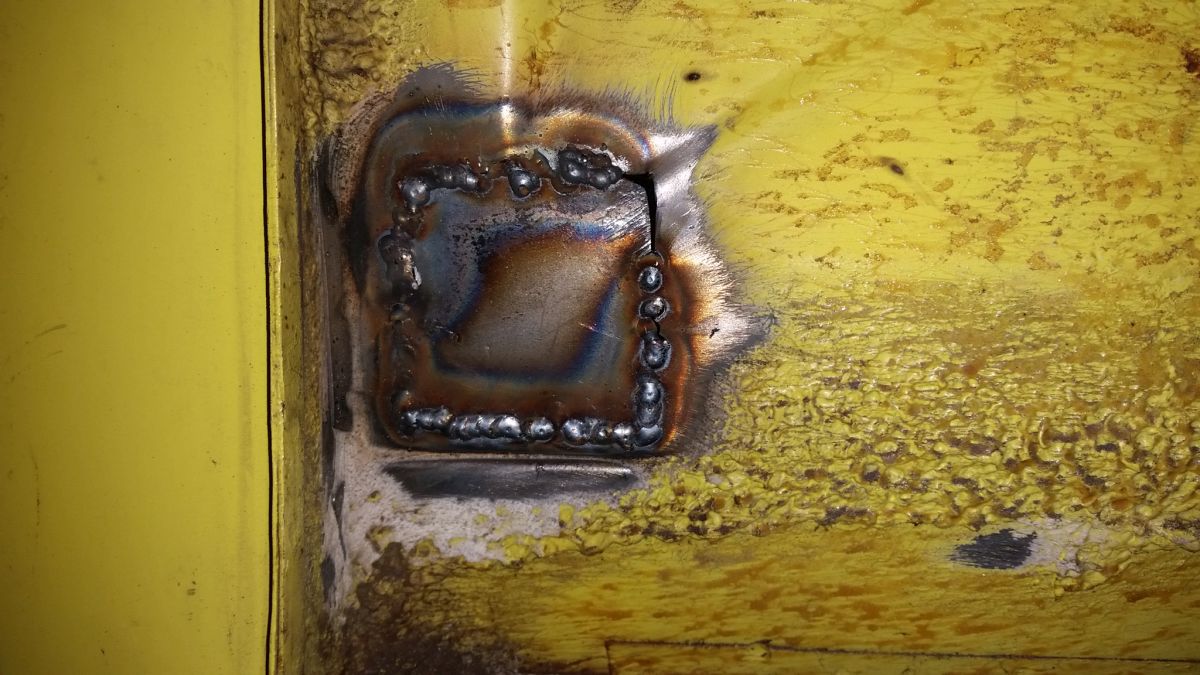

Got the easy ones out of the way this evening....
4.5 hours down, 15.5 hours of rust repair left in the books.
Going to cut open the firewall drivers side tomorrow morning. Then I'll see what else needs to be done in that area.
FYI Replacement metal is 16ga, a bit thick for the 18ga metal in there currently but eh, it works.
After all the firewall is fixed I'll seal it up and hit it with more galvanized primer for the owner to paint.

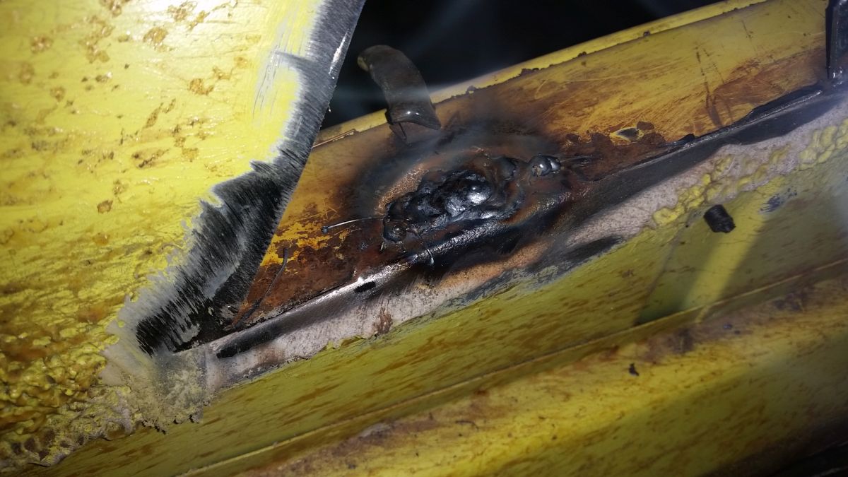

Andyrew   Firewall rust :( The owner and I are discuss...   Oct 22 2015, 11:43 AM
Andyrew   More..   Oct 22 2015, 11:48 AM

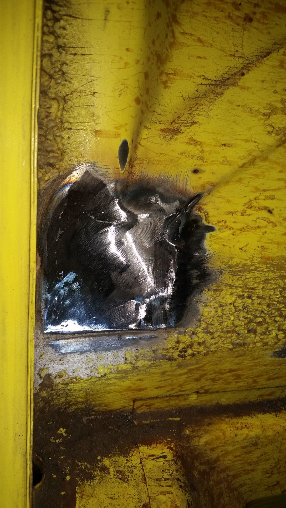

Andyrew   A bit more digging of the rust. As I anticipated i...   Oct 23 2015, 06:38 PM
matthepcat   Yikes. The owner might want to delay engine instal...   Oct 23 2015, 09:52 PM
Andyrew   The owner has agreed to have me repair the rust. I...   Oct 23 2015, 10:05 PM
Andyrew   Got the easy ones out of the way this evening.... ...   Oct 24 2015, 02:44 AM

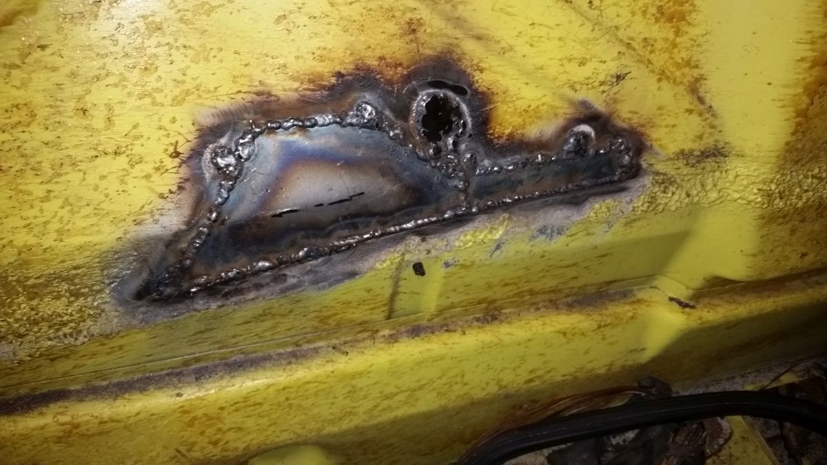

Andyrew   Progress from yesterday morning. Had a concert to ...   Oct 25 2015, 09:37 AM
whitetwinturbo   What is the gooey stuff on the weld line :confuse...   Oct 25 2015, 09:53 AM
Andyrew   What is the gooey stuff on the weld line :confus...   Oct 25 2015, 10:04 AM
whitetwinturbo   What is the gooey stuff on the weld line :confu...   Oct 27 2015, 06:40 PM
Andyrew   Drivers side done :) Now onto the pas...   Oct 25 2015, 07:10 PM
Andyrew   The answer was leave the hole and rip the battery ...   Oct 25 2015, 11:36 PM
