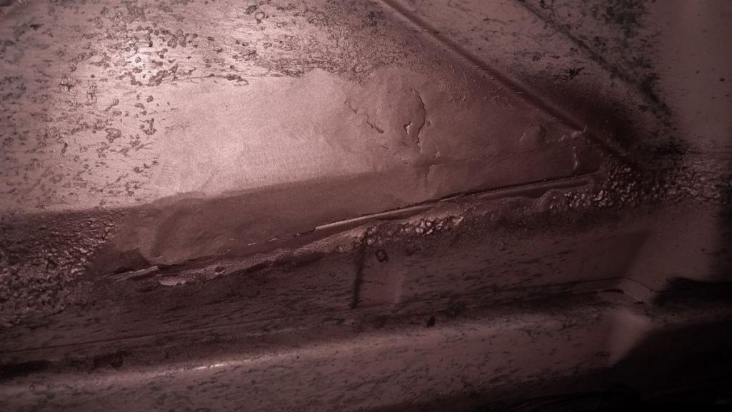

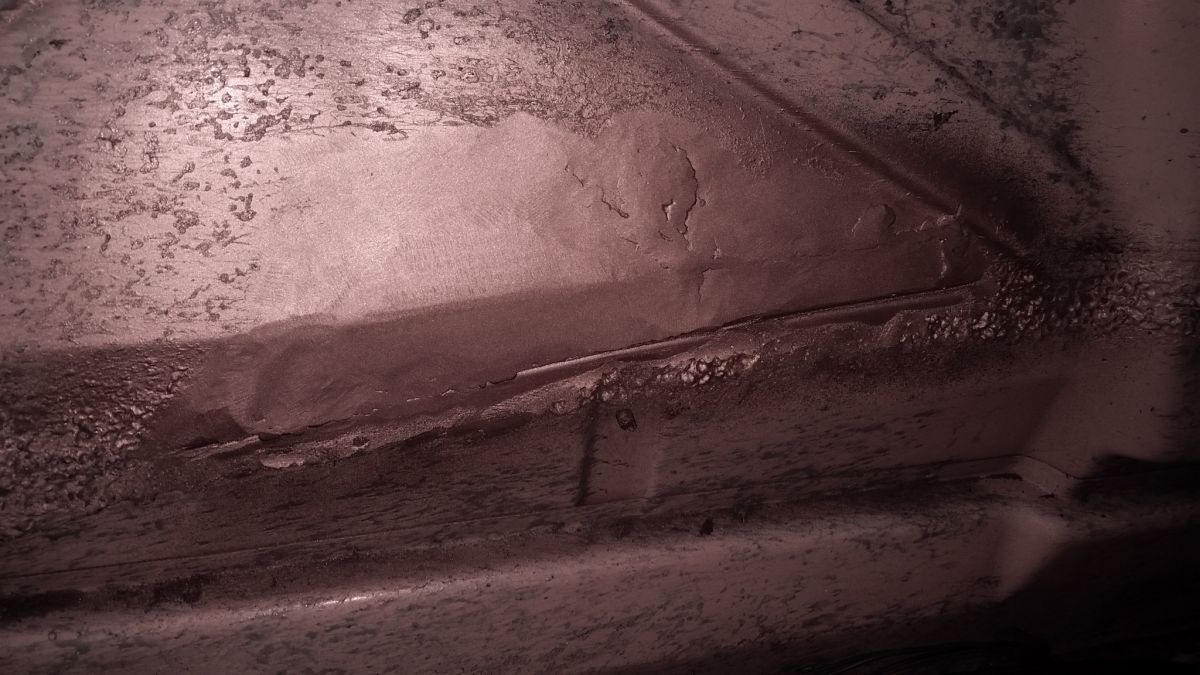

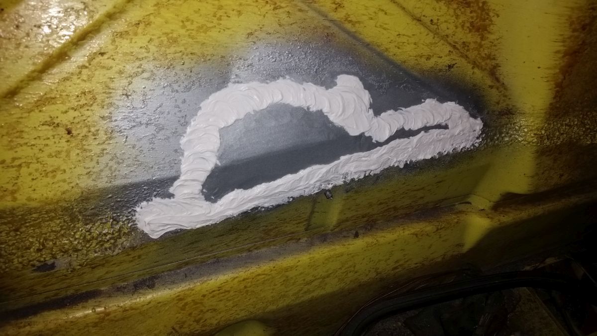

Progress from yesterday morning. Had a concert to go to so progress was stalled... 3 hrs down here.
I really debated even replacing this steel as its not part of the suspension console. But I didnt want to leave it alone. I did a quick and easy patch job on it and will seal it up today after I repair the firewall. Luckily the suspension console seems solid. |

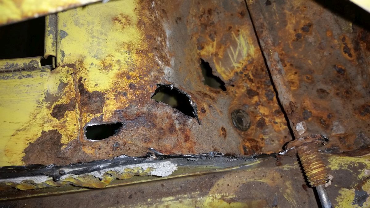

Andyrew A bit more digging of the rust. As I anticipated i... Oct 23 2015, 06:38 PM
matthepcat Yikes. The owner might want to delay engine instal... Oct 23 2015, 09:52 PM
Andyrew The owner has agreed to have me repair the rust. I... Oct 23 2015, 10:05 PM

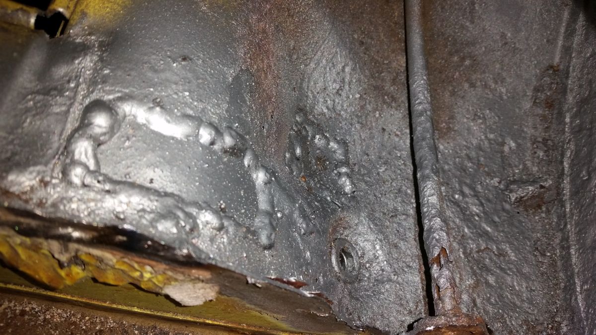

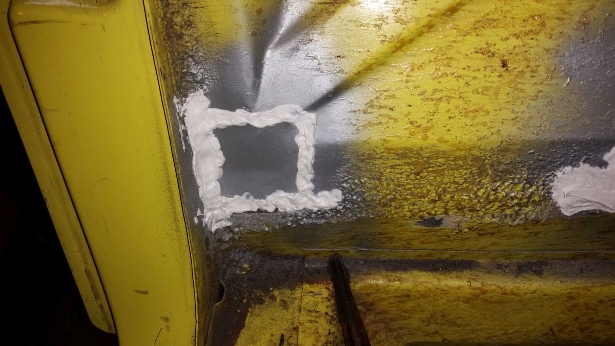

whitetwinturbo What is the gooey stuff on the weld line :confuse... Oct 25 2015, 09:53 AM
Andyrew
What is the gooey stuff on the weld line :confus... Oct 25 2015, 10:04 AM
whitetwinturbo
What is the gooey stuff on the weld line :confu... Oct 27 2015, 06:40 PM
Andyrew Drivers side done :)

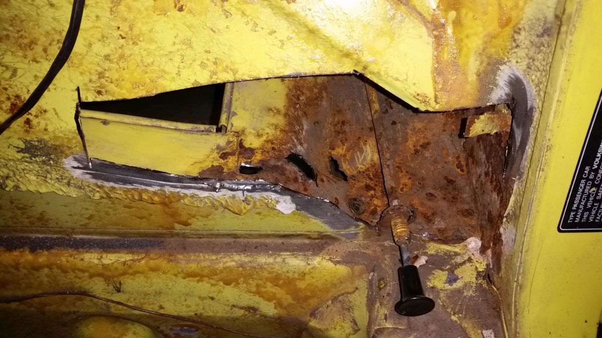

Andyrew The answer was leave the hole and rip the battery ... Oct 25 2015, 11:36 PM
