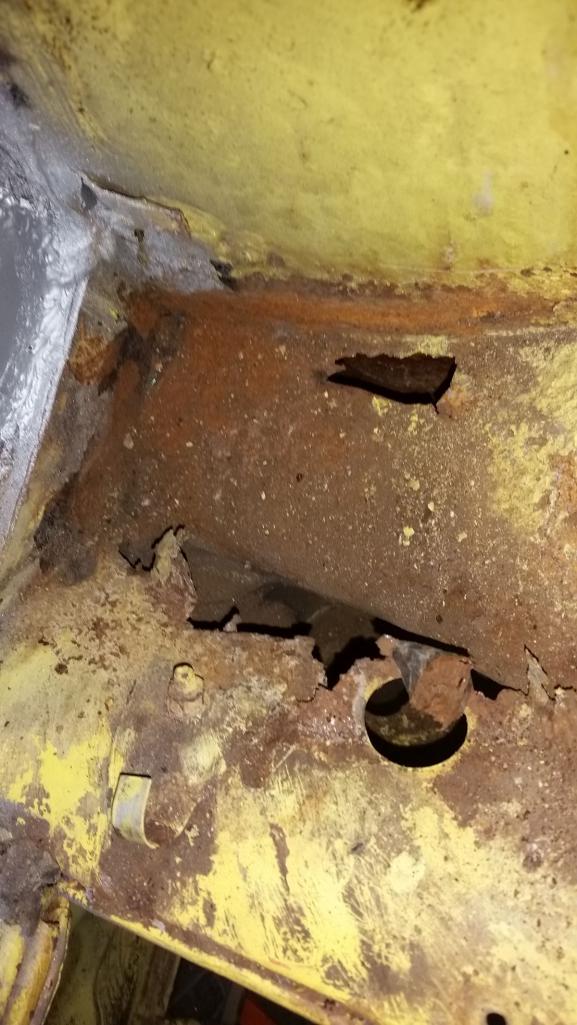

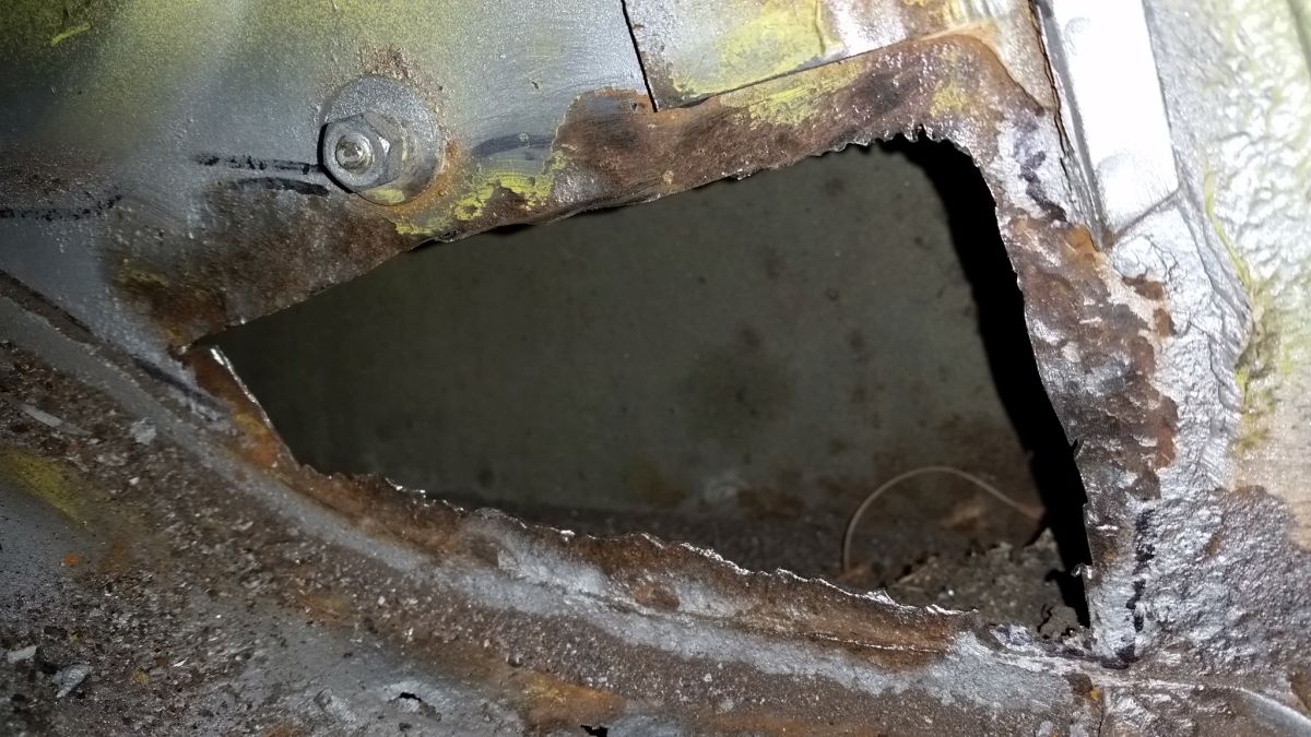

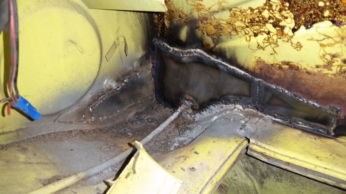

Andyrew   Firewall rust :( The owner and I are discuss...   Oct 22 2015, 11:43 AM
Andyrew   More..   Oct 22 2015, 11:48 AM

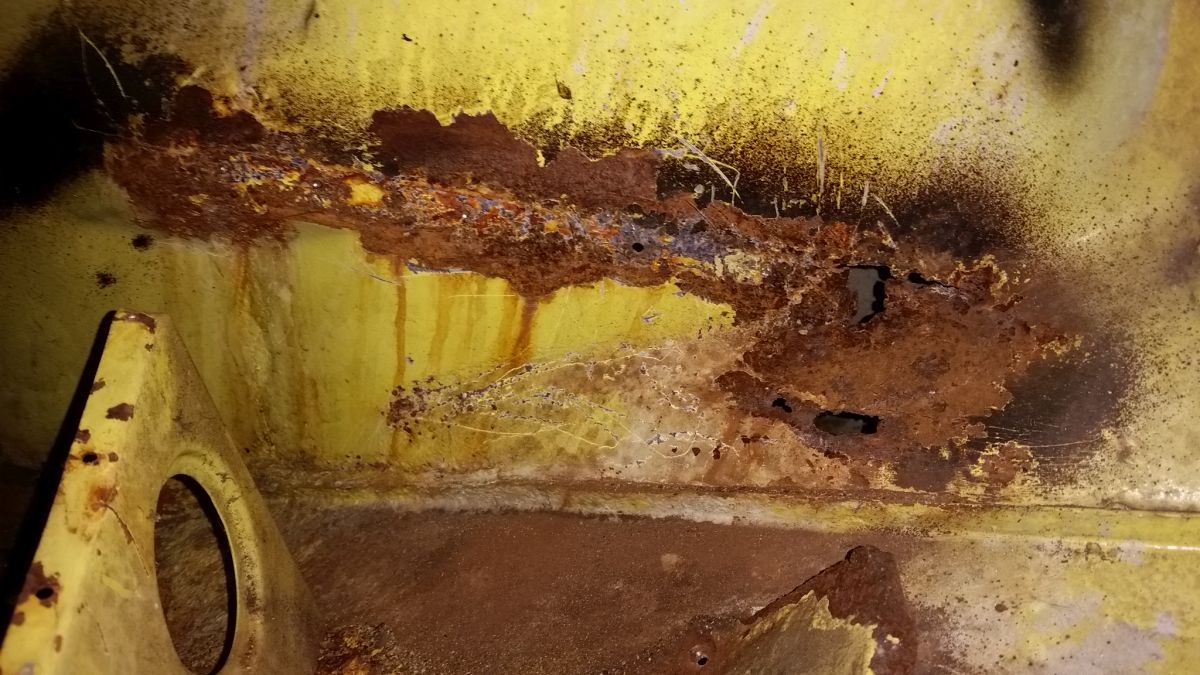

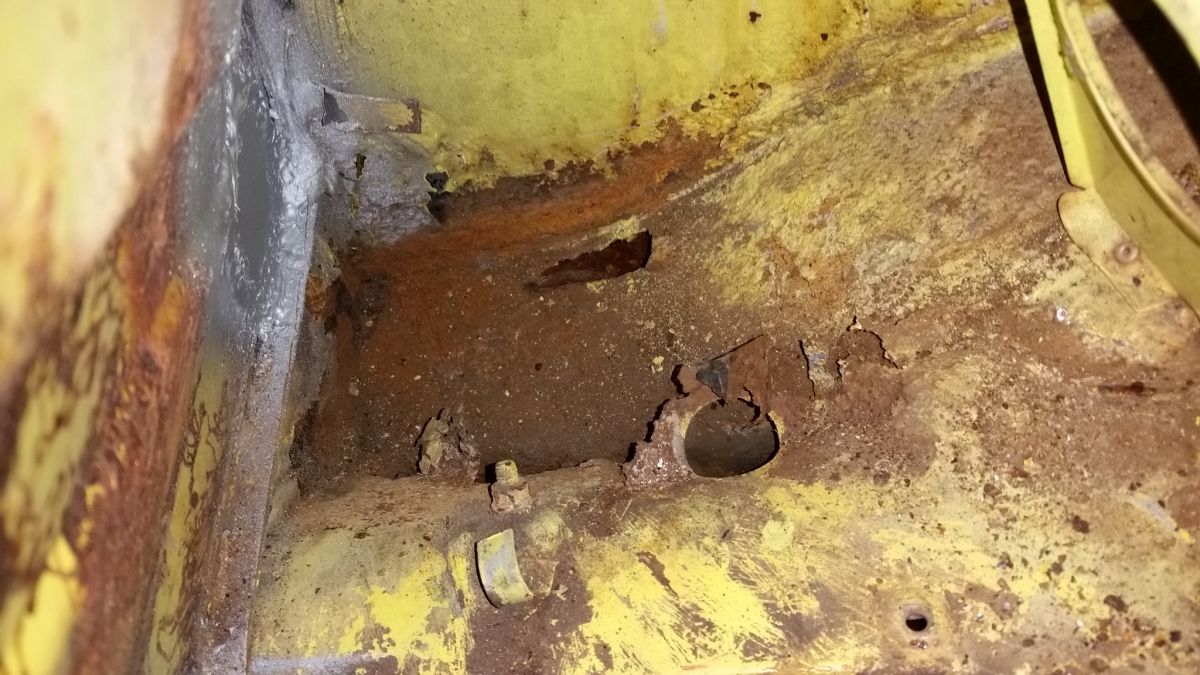

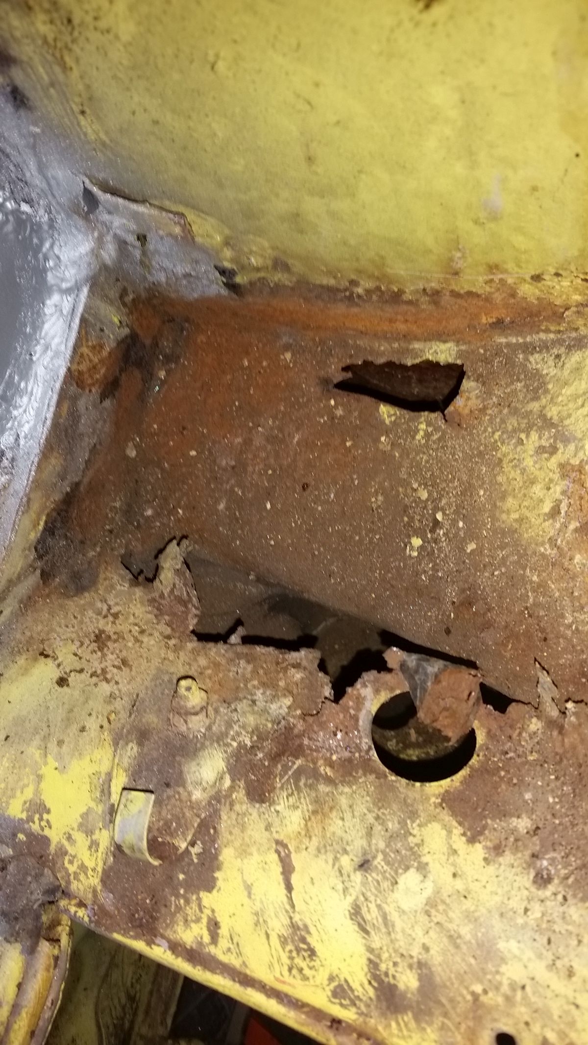

Andyrew   A bit more digging of the rust. As I anticipated i...   Oct 23 2015, 06:38 PM
matthepcat   Yikes. The owner might want to delay engine instal...   Oct 23 2015, 09:52 PM
Andyrew   The owner has agreed to have me repair the rust. I...   Oct 23 2015, 10:05 PM

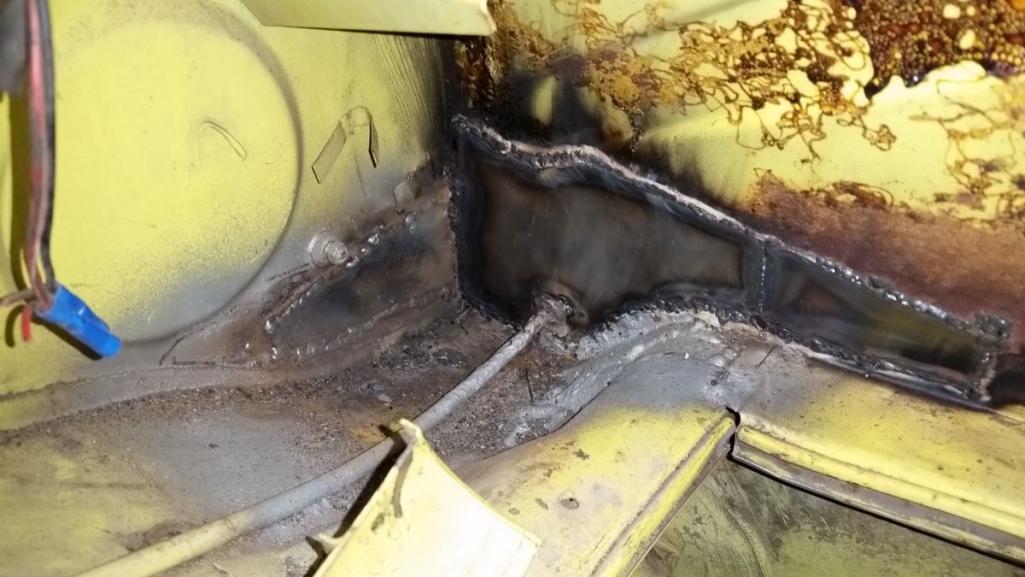

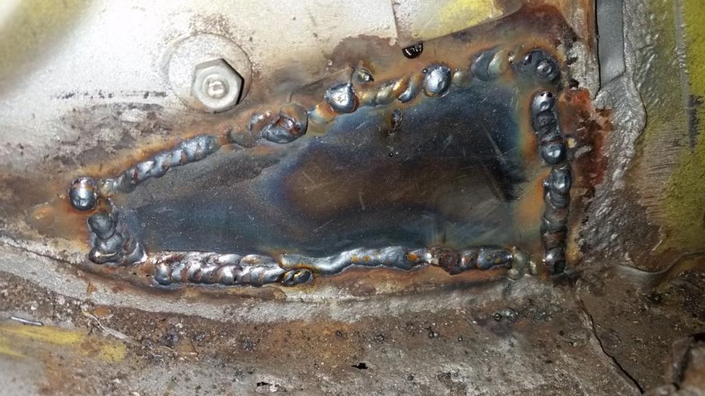

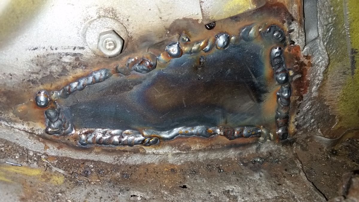

Andyrew   Got the easy ones out of the way this evening.... ...   Oct 24 2015, 02:44 AM
RobW   Nice work. Full service. :headbanger:   Oct 24 2015, 05:14 AM

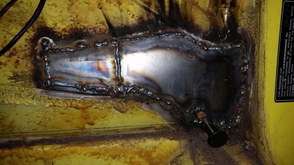

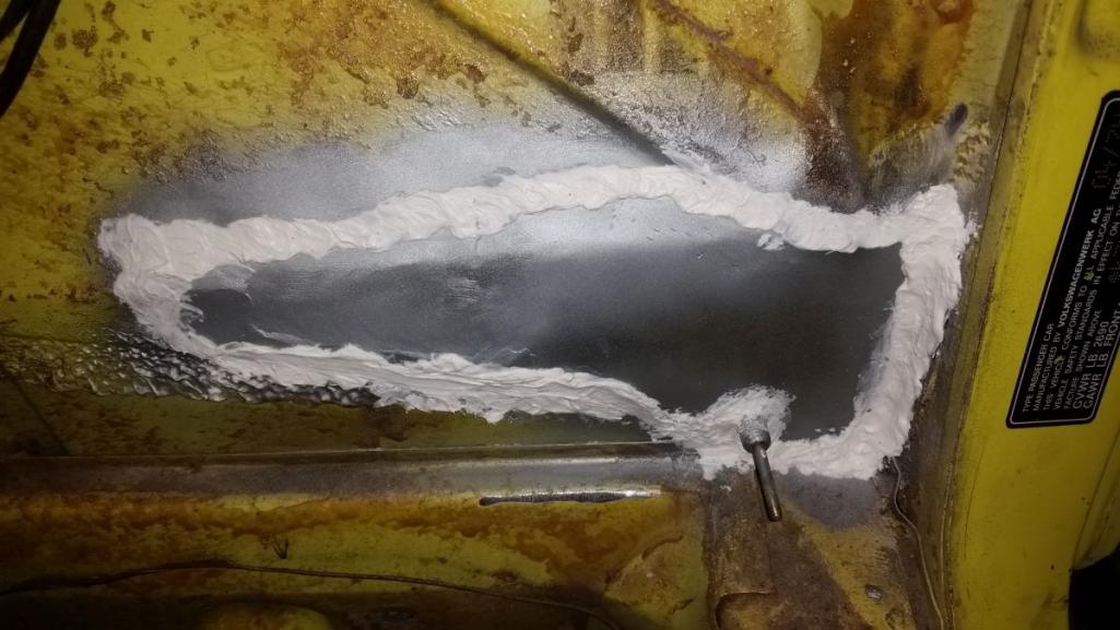

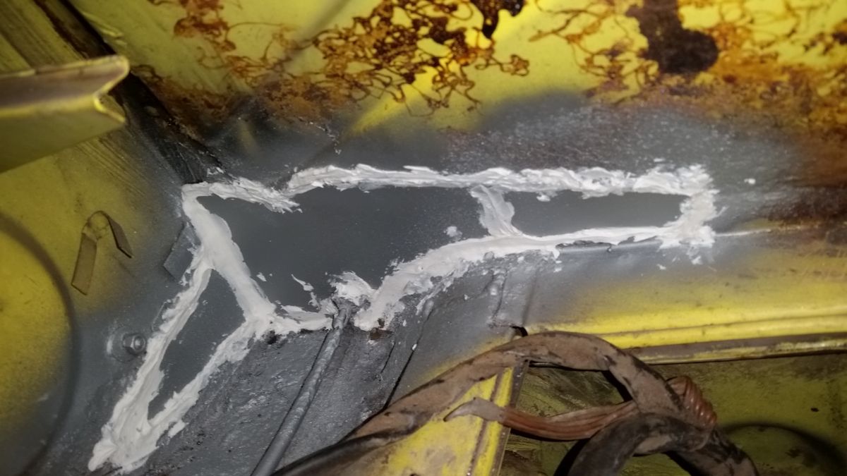

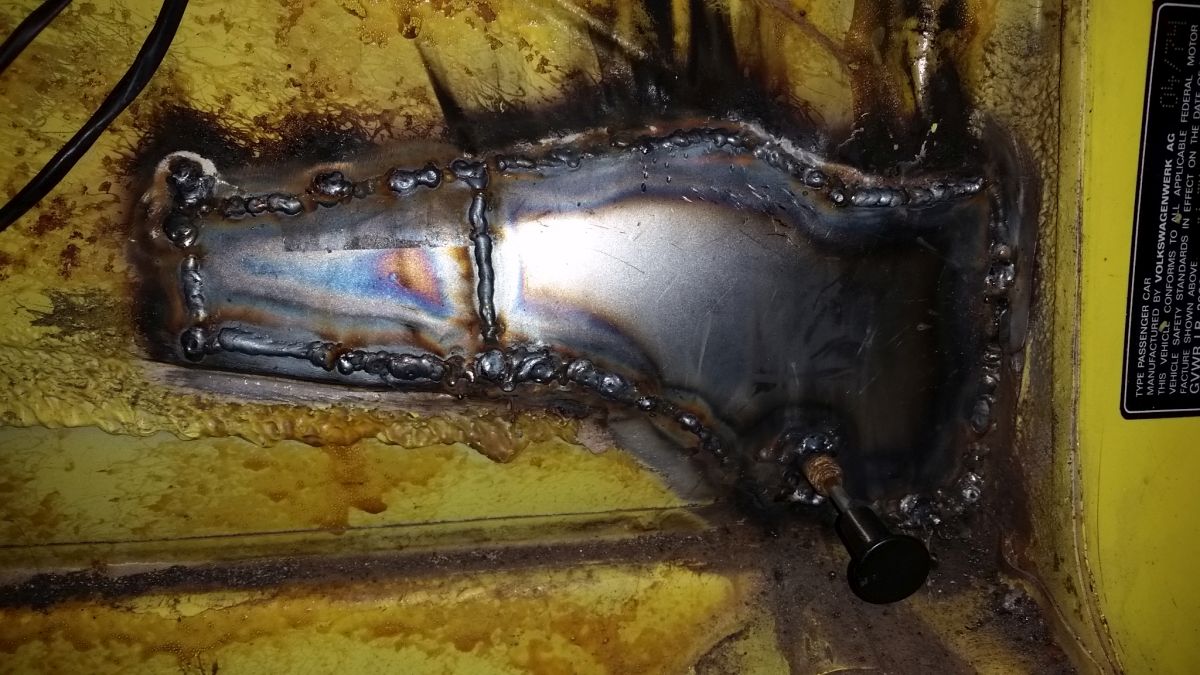

Andyrew   Progress from yesterday morning. Had a concert to ...   Oct 25 2015, 09:37 AM

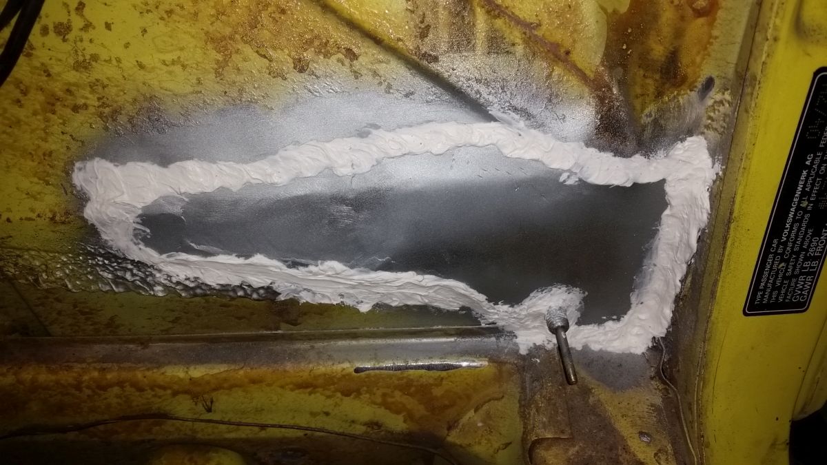

whitetwinturbo   What is the gooey stuff on the weld line :confuse...   Oct 25 2015, 09:53 AM
Andyrew   What is the gooey stuff on the weld line :confus...   Oct 25 2015, 10:04 AM
whitetwinturbo   What is the gooey stuff on the weld line :confu...   Oct 27 2015, 06:40 PM
Andyrew   Drivers side done :) Now onto the pas...   Oct 25 2015, 07:10 PM
