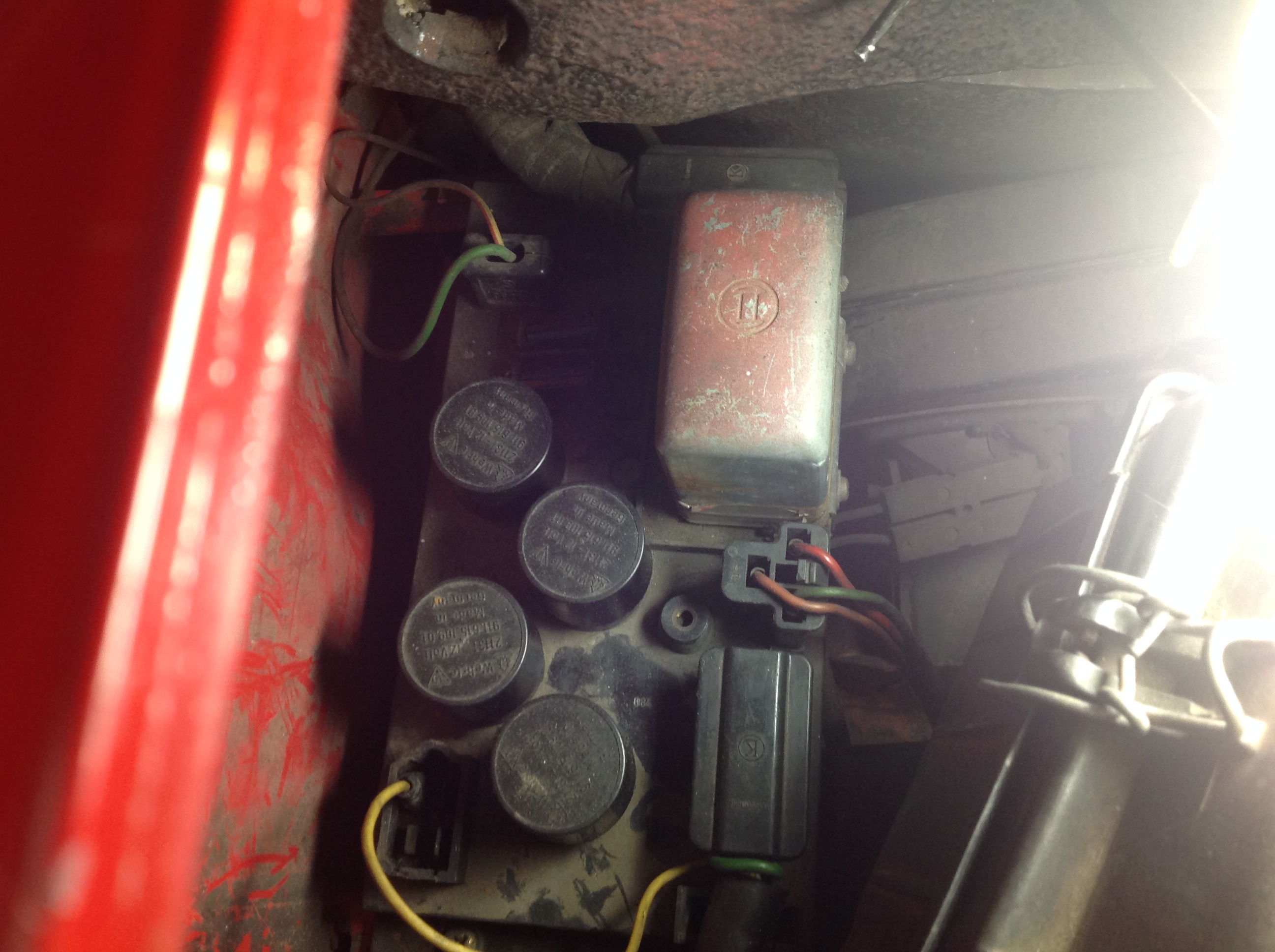

Can you post a pic of your relay board?

Relay board picture:

brooks944   Relay board picture:   Oct 29 2015, 05:02 AM
timothy_nd28   Remove the lonely yellow wire (has red circle arou...   Oct 29 2015, 09:20 AM
brooks944   Tried it in both of the rear one, not turning over...   Oct 29 2015, 01:57 PM
timothy_nd28   Okay, leave that yellow wire plugged into one of t...   Oct 29 2015, 02:08 PM
brooks944   Do I put the positive from the voltmeter on the pi...   Oct 29 2015, 02:32 PM
timothy_nd28   Yep, I would pull off the 14 pin connector, and in...   Oct 29 2015, 02:36 PM
brooks944   Thanks it may take a day or two to test, I will le...   Oct 29 2015, 04:39 PM
brooks944   The wires to the coil also look pretty fragile, pl...   Oct 29 2015, 05:19 PM
