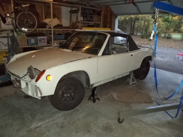

thank god I had the hoist... no way could I have installed 4 doors without it... would have had to ask the wife for help/muscle (IMG:style_emoticons/default/smile.gif)

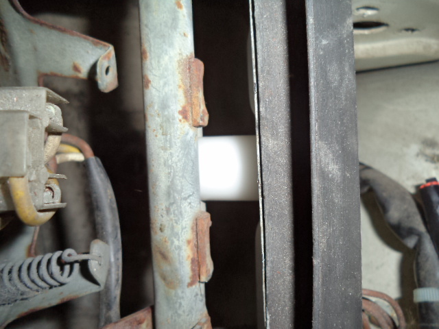

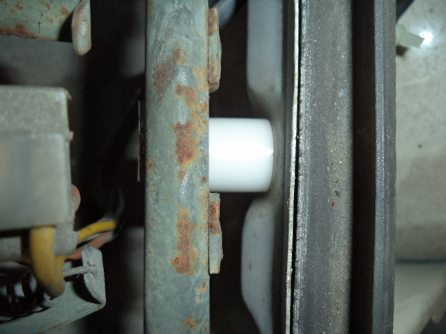

jimkelly   decided that I will just put a delrin spacer here ...   Oct 18 2015, 05:54 AM

jimkelly   white doors are back on my 1975 and red doors are ...   Oct 31 2015, 04:37 PM
914forme   And to think I just man handle doors in place, put...   Oct 31 2015, 05:09 PM
jimkelly   thank god I had the hoist... no way could I have i...   Oct 31 2015, 06:50 PM

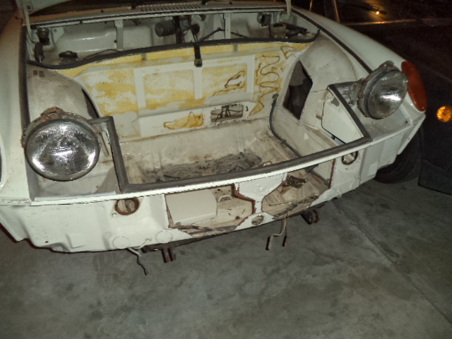

jimkelly   just stripped down the bumper. i'll be return...   Nov 1 2015, 10:26 AM
