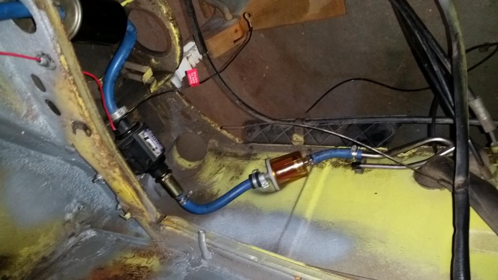

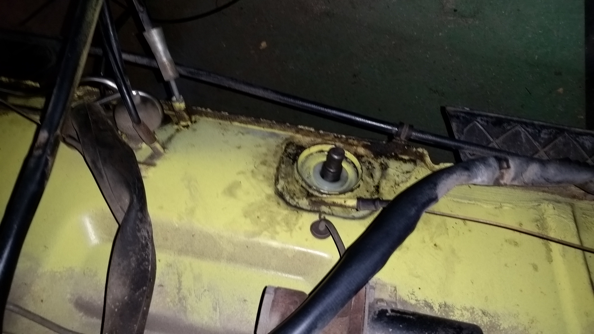

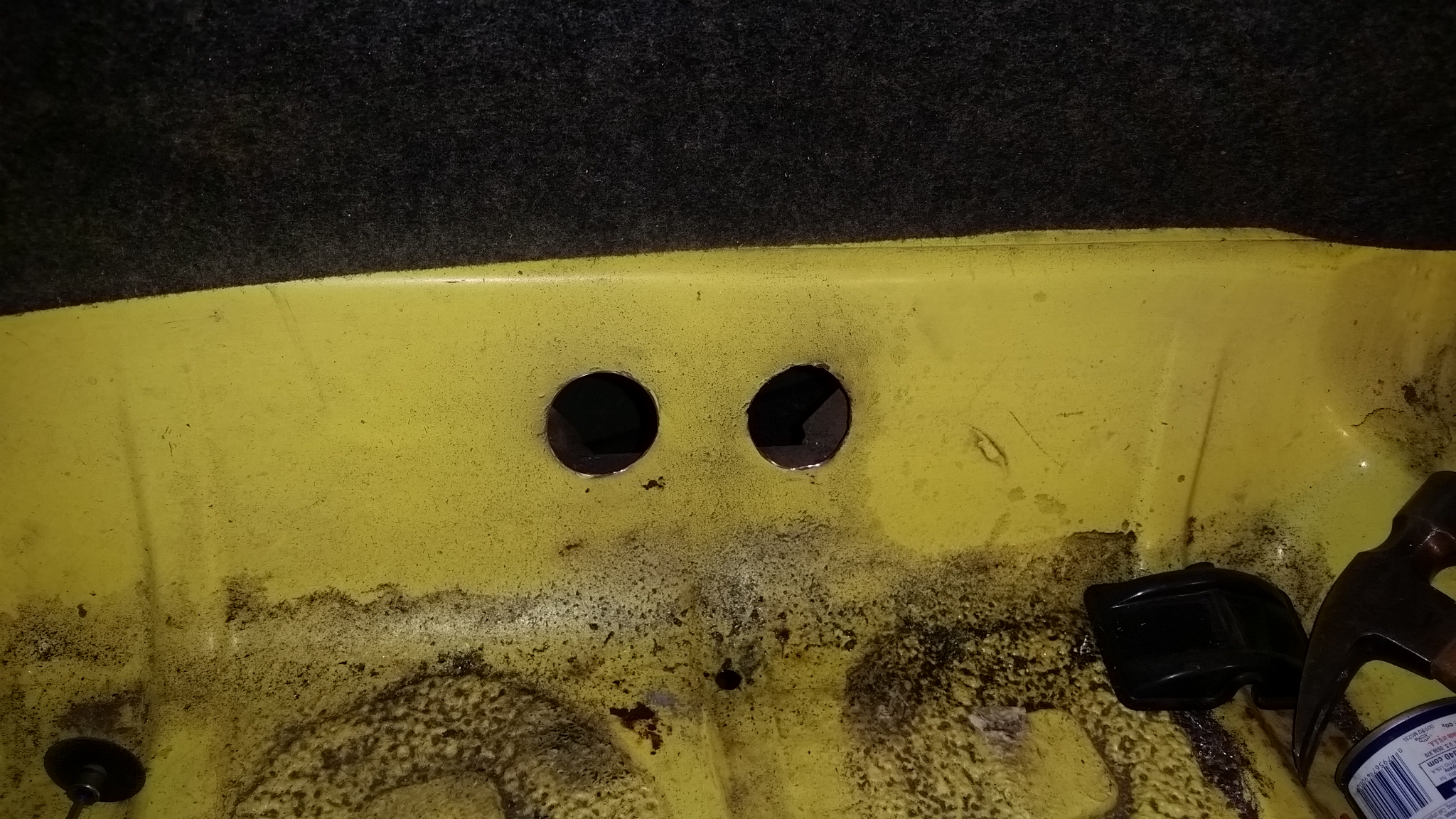

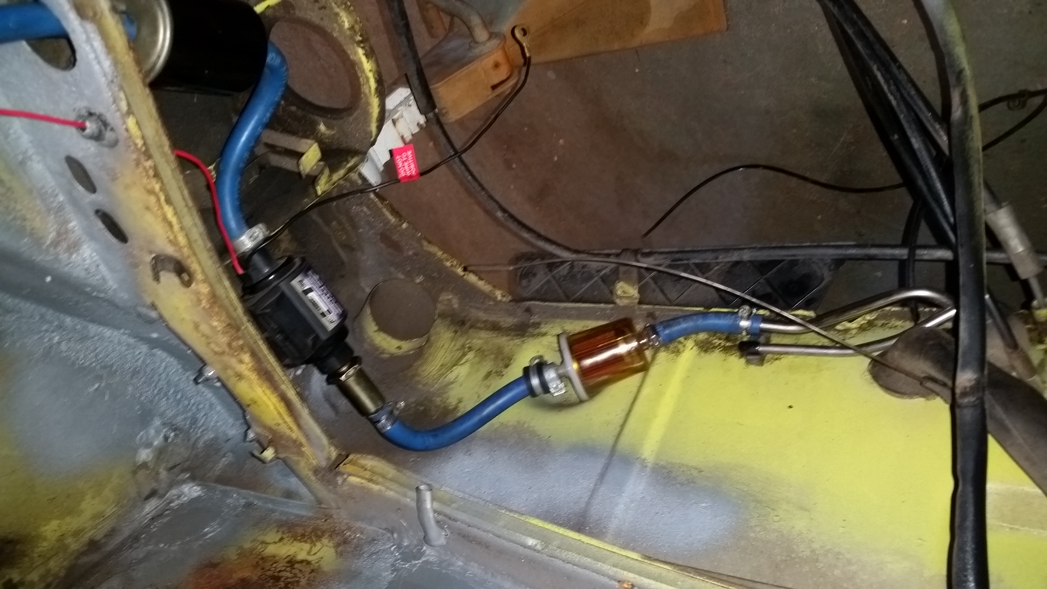

Fought a cold ALL week so I didnt make any progress durring the week.
This morning before Halloween prep I did a little bit of work.
Installed the firewall bushing
Installed the fuel pump and filters onto the new fuel lines
Cutout the holes for the radiator lines in the front trunk.
