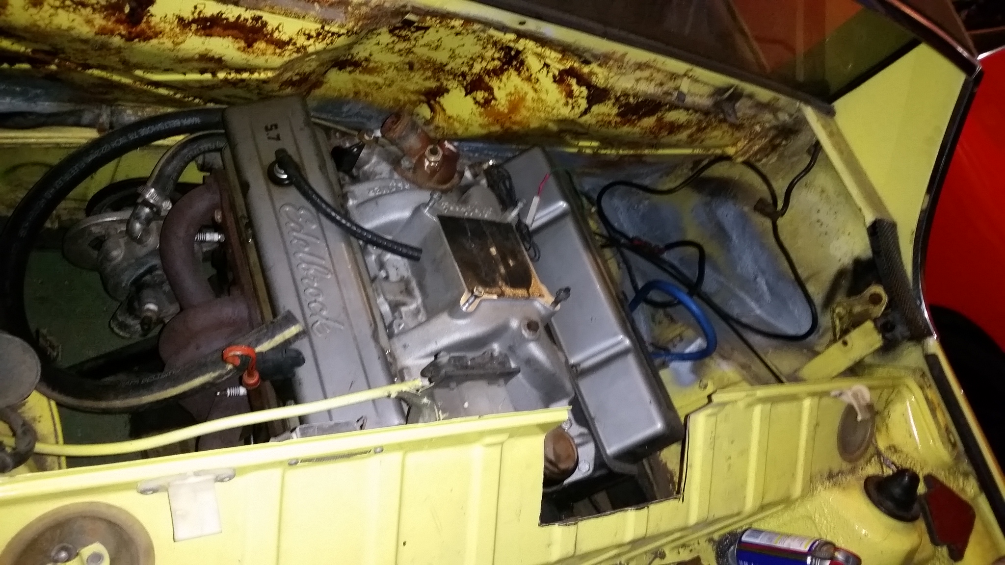

Installed new water and alternator belts.
Removed the exhaust as I didnt want to bother breaking the stub axles loose. Seemed like an easier option since there was no handbrake or anything and the piping was in the way of the CV joints. Luckily the bolts were not rusted and it only took about 40 minutes to remove the exhaust, Hopefully it goes back on that quickly..
Clearance for the dizzy and removed the hood torsion bars (Brett you'll need to order some trunk shocks or use a hood prop)
Mounted the new rear trani mounts and the trani 100%, and I got the front bolted up but not snugged up. The engine should raise about an inch once its all snugged up.

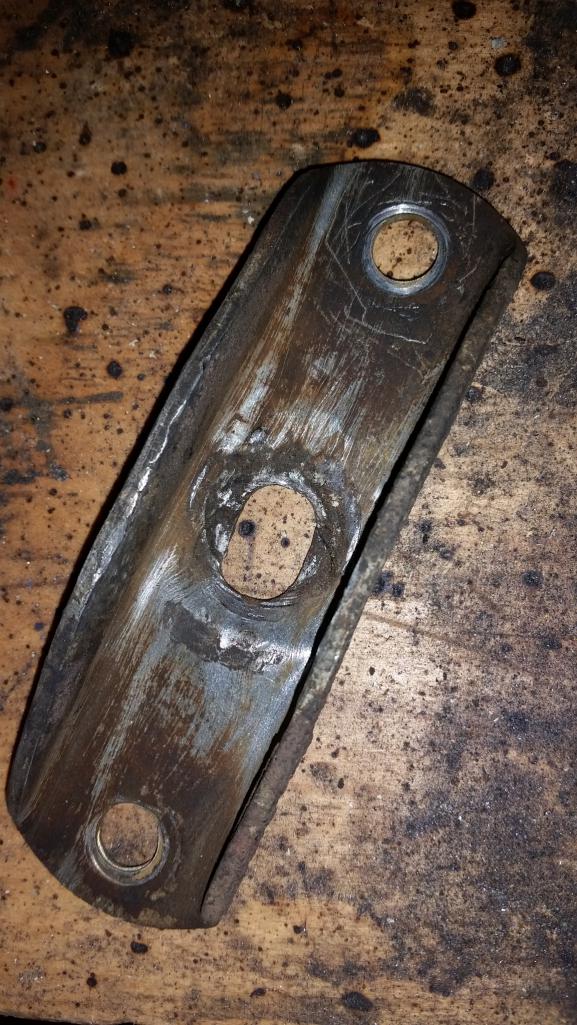

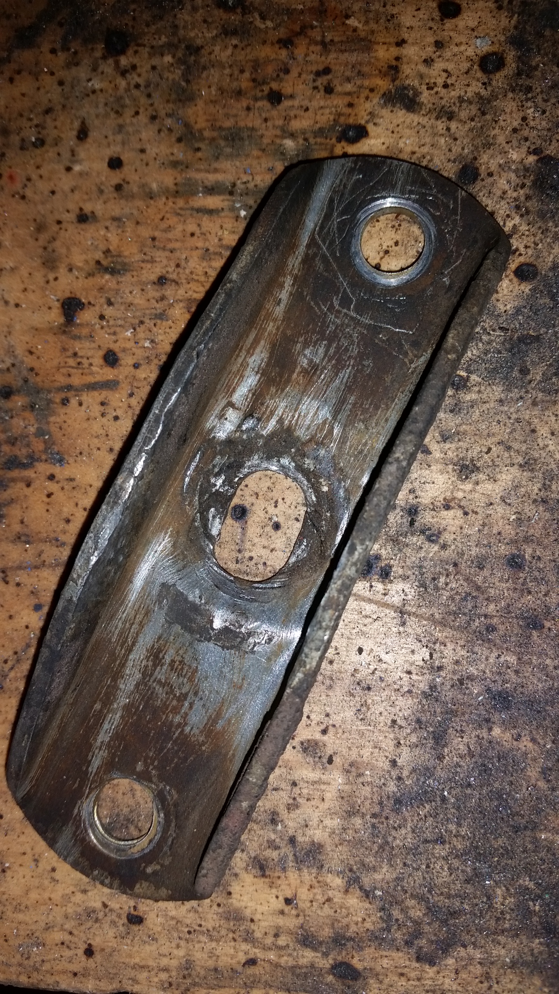

Had to use my mounts for the front since the car didnt have any on them, and the rear trani mount bolts had no nuts so I had to use mine..(Brett, you'll need to give me these AND the big bolts that go to the crossmember from your car) In doing so I saw that the front brackets from my car one of them was pretty damaged so I welded on a reinforcement to it. No pics of the repair with 1/8" steel.
So engine is in place and the rest of my time is all the little things.
