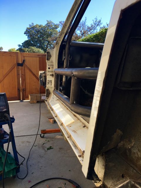

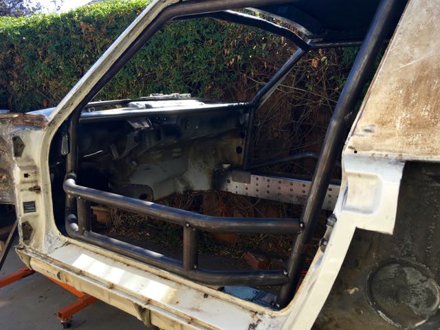

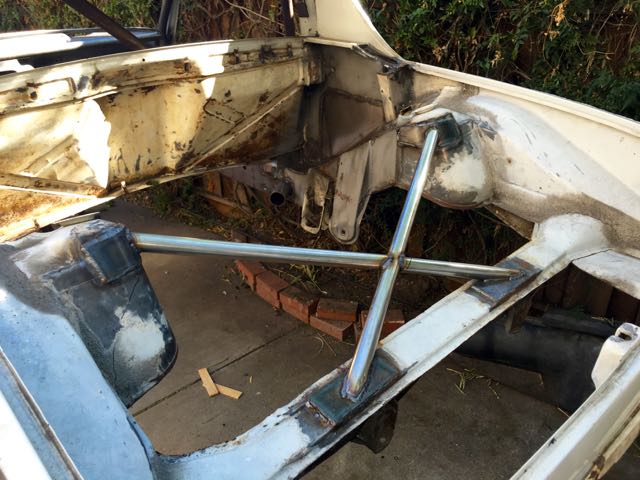

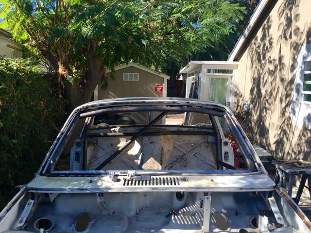

Finally was able to get some time on the project this weekend, and it was all dedicated to the roll cage. Was able to fit the driver door bars, the knee bar, and the windshield bar. These are just tacked in for now. The passenger door bars still need to be cut down and fitted.
I was also able to add the trans reinforcements, but I still need to add a cross bar between the towers.
Finally, I was able to cut and burn in the backing plates to tie the main hoop of the cage to the rear shock towers. I also plan to tie in the front towers to the forward hoops but I haven't gotten around to making the plates yet. Soon.
This chassis fab stuff just takes so long and its so tempting to cut corners for the sake of expediency. A day here, a day there, its just a matter of being patient and working hard. I got the sign-off from Chris @ Tangerine on the placements, so Im feeling pretty good about burning it all in once the passenger bars are fit. Onward!
