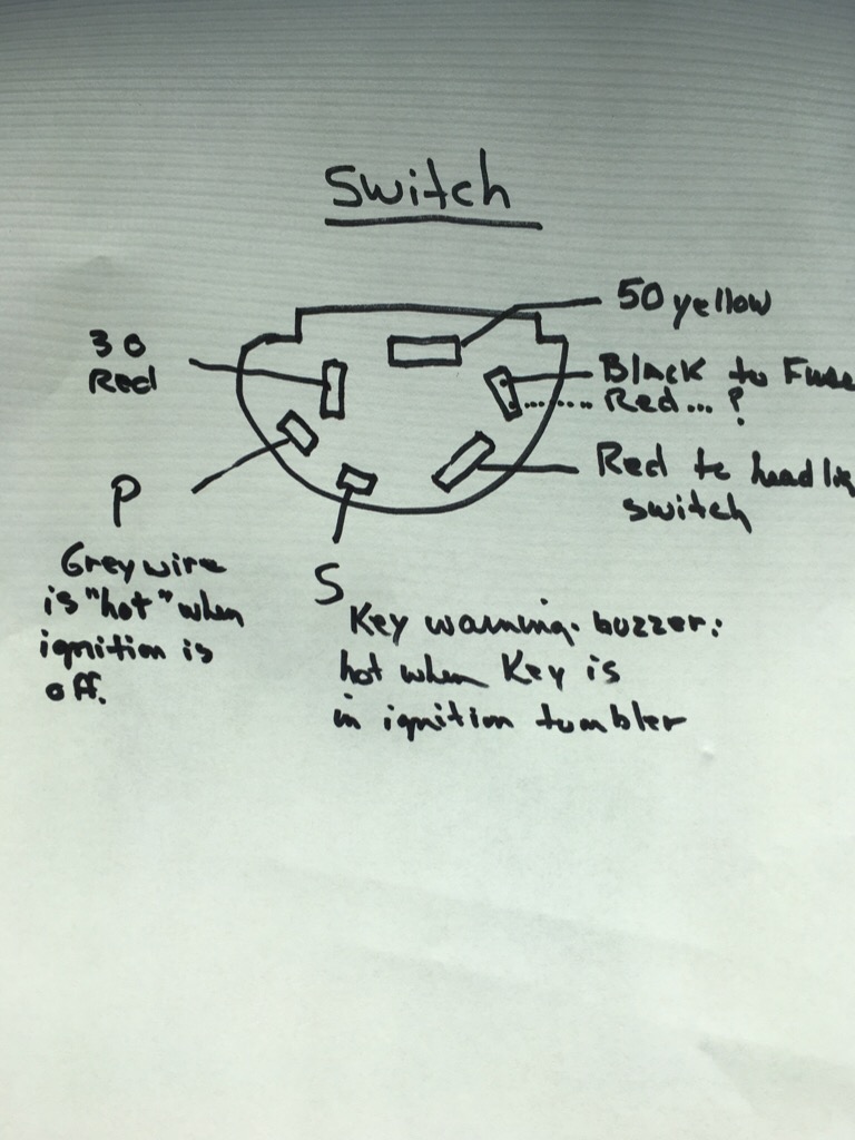

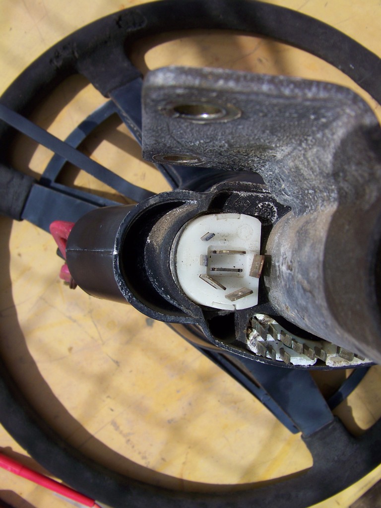

OK; Now, what wire goes from the ignition switch to the buzzer ? I'm trying to re-establish the connection(s)
I assume that the connection is a ground type: key-in maintains the ground to the buzzer; key-out breaks the ground connection and ends buzzing. So, I need the wire color code and or connector on the ignition switch it goes to.

CooltimesJr   got an ohm meter? i'm wondering if the two sma...   Nov 6 2015, 06:24 PM
jim_hoyland   got an ohm meter? i'm wondering if the two sm...   Nov 6 2015, 06:45 PM
jim_hoyland   I had a change to do some testing on a switch that...   Nov 8 2015, 06:42 PM

Root_Werks   I used this wire to power the "on" for m...   Jun 25 2025, 09:39 AM
JeffBowlsby   Chassis harness schematic says its the grey/brown ...   Jun 25 2025, 10:42 AM
Root_Werks   Chassis harness schematic says its the grey/brown...   Jun 25 2025, 11:20 AM

jim_hoyland   Thanks for all that information :) Here’s what...   Jun 25 2025, 06:38 PM
Root_Werks   I believe the grey wire with brown stripe has 12v ...   Jun 25 2025, 07:34 PM
Root_Werks   BUT, if you're looking for a chime, this won...   Jun 25 2025, 07:36 PM
