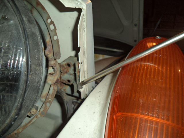

guess if I just remove lens, maybe I would have a lesser angle on screw driver to install this last screw?

jimkelly   guess if I just remove lens, maybe I would have a ...   Nov 7 2015, 11:46 AM
914forme   Small bit and bit holder does the trick also, remo...   Nov 7 2015, 02:03 PM
jimkelly   (( driver bit in fingers seems like a decent solut...   Nov 7 2015, 02:19 PM
