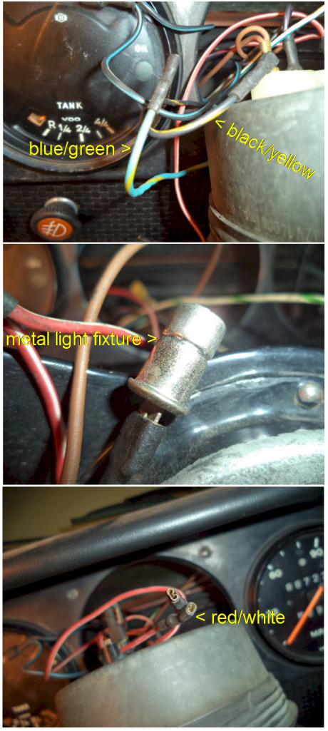

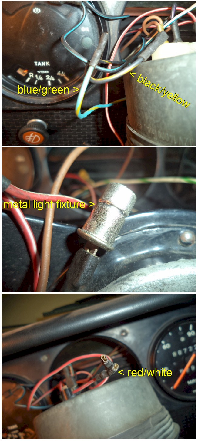

so, got gauges mostly installed but have a few EXTRA wires (IMG:style_emoticons/default/sad.gif)
red/white with 2 small connectors on it
blk/yel - with 1 small connector on it
blue/green - with 1 small connector on it
and it seems I do not have enough metal light fixtures? calling mark (IMG:style_emoticons/default/popcorn[1].gif)
my recommendation is everyone should have a parts car rusting away in their back yard (IMG:style_emoticons/default/wacko.gif)
