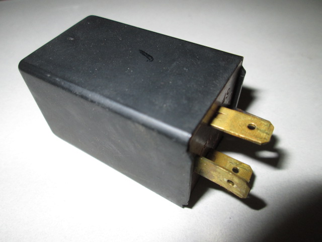

jimkelly   $35 ebay actual unit as received   Oct 1 2015, 06:33 PM
