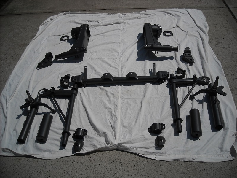

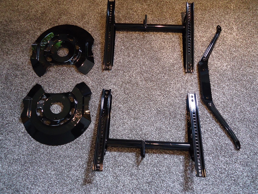

Still doing body work on the Pass side fenders. not much to show there.
Picked up some parts from the powder coaters, more stuff no one will see.

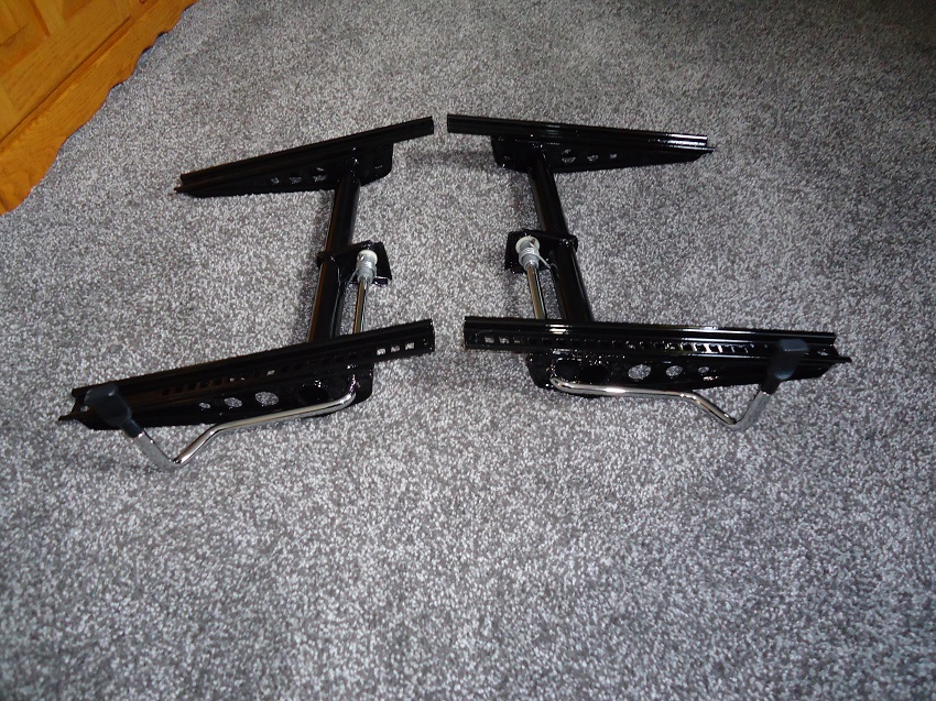

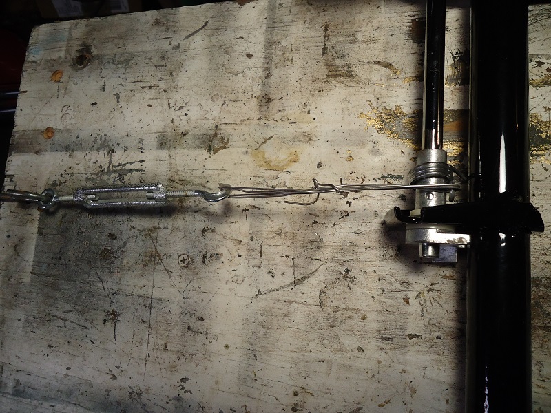

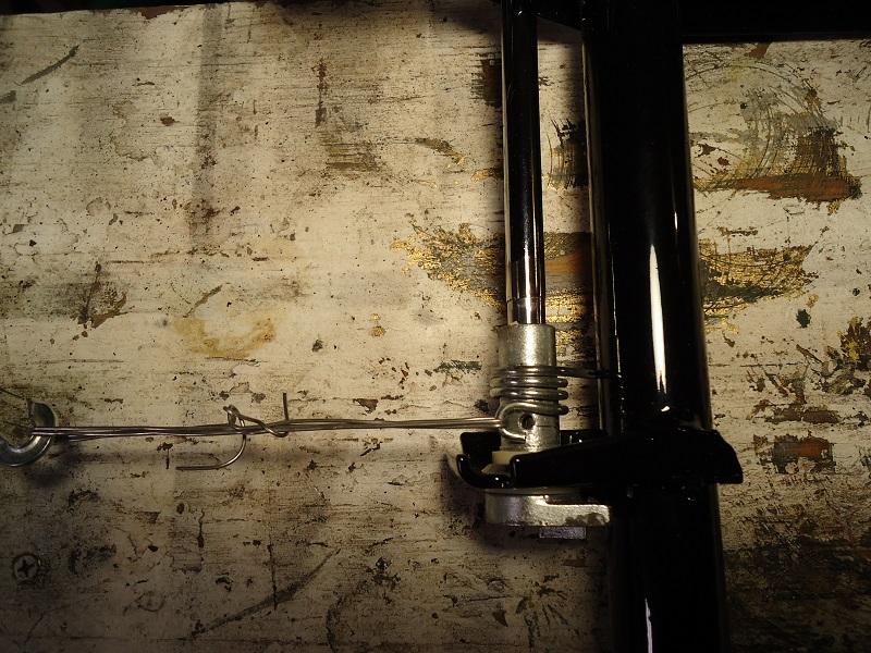

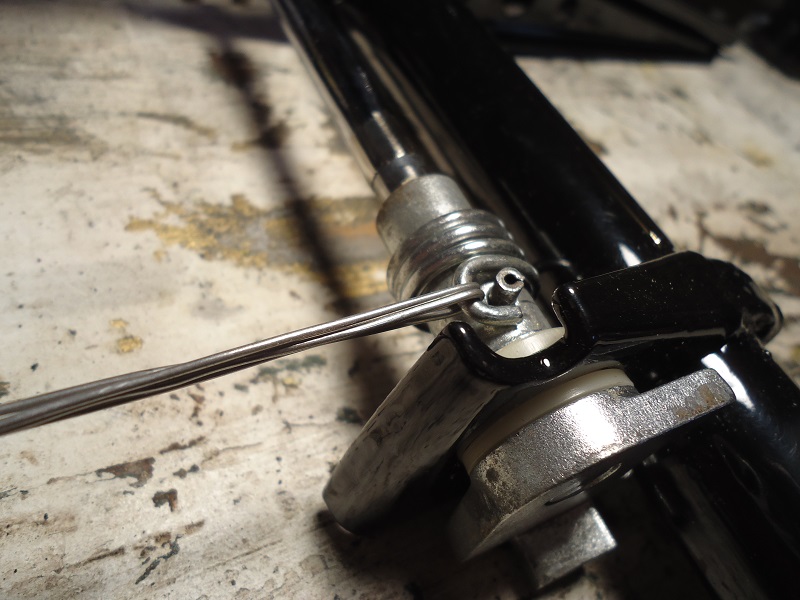

On the seat mounts I had to devise a way to remove the spring for the tilt mechanism, This is what I came up with. It worked good for both disassembly and reassembly, without damaging my new powder coat.
I put a couple screws in to hold the seat mount and the turnbuckle worked beautifully to pull the spring so I could drive in the pin...
And finished.....
Yeah, I had the tilt levers CHROMED... a good friend runs a chrome shop. I couldn't help myself...
Like I said, More stuff no one will see....
