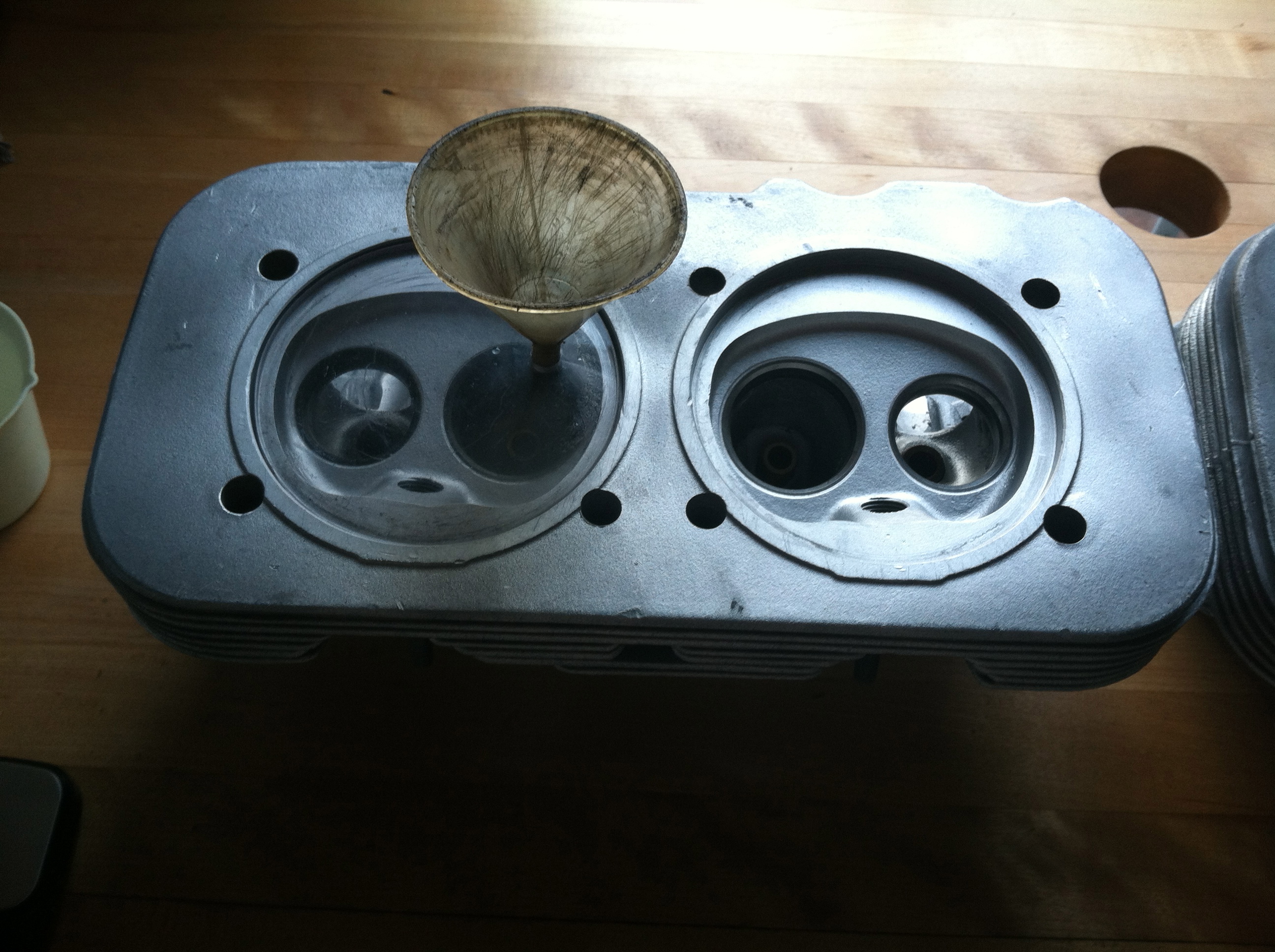

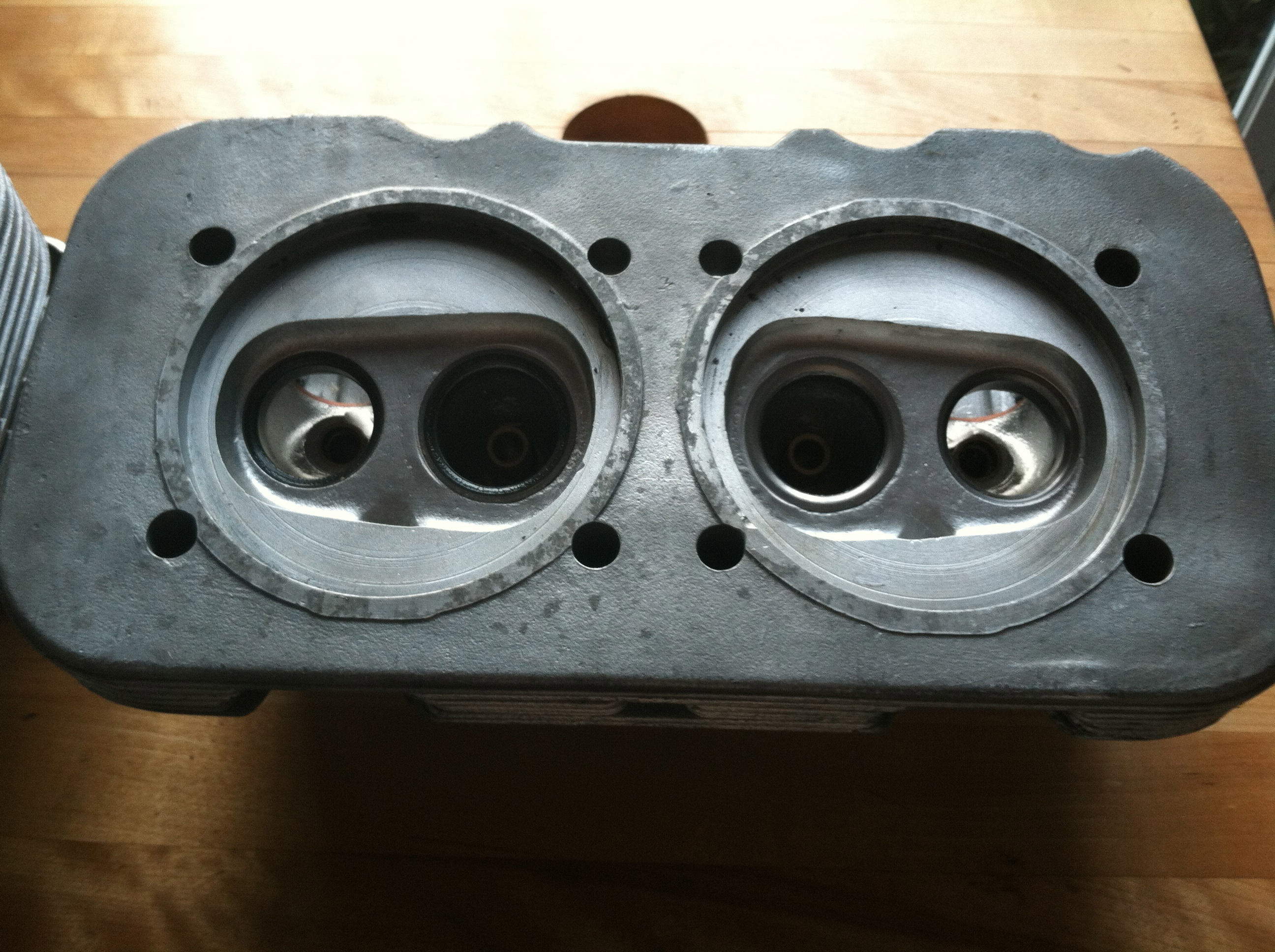

Good timing,
I'm just getting to get my heads cleaned up for new 2056 build.
Car came with 4 intake bolt heads even though it was a 2L 1976 car
I subsequently bought another 2L motor with the correct 3 bolt heads.
I just cc'd the different heads and there is quite a difference in chamber volume, both appear to be un-touched.
4 bolt heads are P/N 022 101 372G (bus heads) cc= 48
3 bolt heads are P/N 039 101 171A (2L) cc=60
Visually quite different chamber shapes see photos
The 2L photo has my plexiglas cover holding the funnel used in the cc'ing process.
