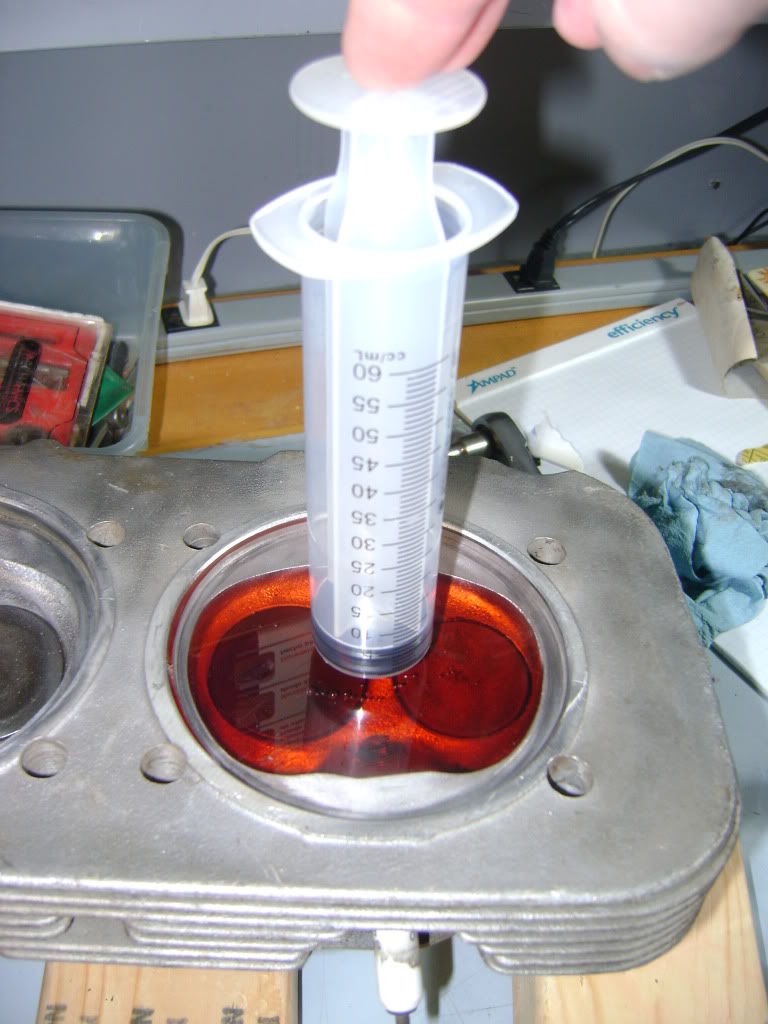

I read precisely 60ccs on the 2.0L heads which was ironic since I bought a 60cc veterinary syringe to do it.
(IMG:http://www.914world.com/bbs2/uploads_offsite/i366.photobucket.com-10819-1447446900.1.jpg)
And those heads look pristine.
And you aren't fooling anyone with that pic.
You cant check comb volume with the valves missing..... :-)
