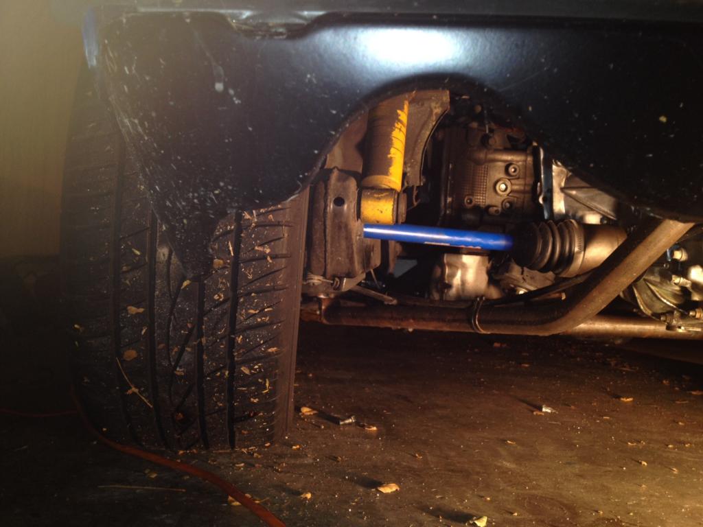

(IMG:http://www.914world.com/bbs2/uploads_offsite/i255.photobucket.com-2618-1269179830.1.jpg)
That's my trunk, to fit a WRX engine with flipped manifold. The big bump up on the right is for the turbo, which you wouldn't have. The freeze plug in the middle is for the clutch slave fluid fitting, and the left bump is for the starter. I saw that someone else used a different starter so was able to avoid that clearance problem. It's is quite a bit of extra work to flip the manifold, but probably cheaper than 930 CV's and you don't have to worry about CV longevity because of that angle. There are some other photos in my thread showing how the engine could actually come back even further except for the plumbing for the turbo.
To know about max angles give Sway-a-Way a call. They've done lots of off-road cars with extreme axle angles for maximum suspension travel so they should be able to tell you what's possible and what's too much.

It looks like these CV's on your photobucket have a bit of an angle as well:
(IMG:http://www.914world.com/bbs2/uploads_offsite/i379.photobucket.com-17072-1447565868.1.jpeg)
What's the story there?
