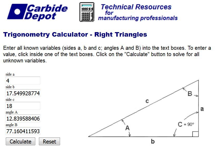

Calculating the Angle of the CV joint.
Web Trigonometry Calculator
Good News. It pays to know your math. Or, to enlist your daughter to remind you how. So my angle is only at 12.84 degrees which should be within the 944 CV joint tolerance (22 degrees) when upgrading to the 5 lug wheel. Here's the calculation with angle A being the critical angle and 4 inches of offset with the 18 inch axle:
(IMG:http://www.914world.com/bbs2/uploads_offsite/i1301.photobucket.com-17072-1447647532.1.jpg)
(IMG:style_emoticons/default/rolleyes.gif)
So, I don't have to move the engine back!!!!!!!!!!!!!!!
Math is fun. And saves time and money!!!!
