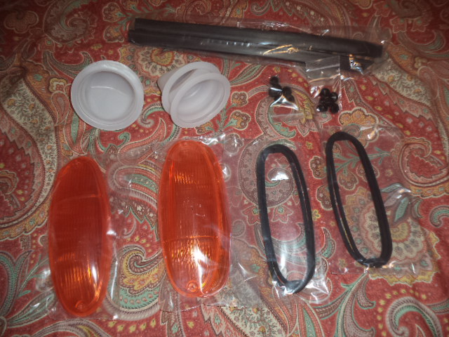

got me some stuff from 914rubber (IMG:style_emoticons/default/smile.gif)

jimkelly   got me some stuff from 914rubber :)   Nov 25 2015, 09:41 PM
