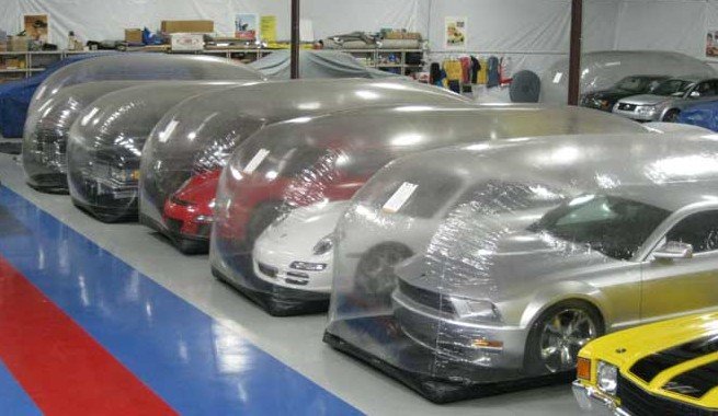

So here's the question: if I buy this 914 it will go into dry storage, but it may be as much as five years before I can get into serious restoration mode on it. Business is going to take me away for an extended period, and this is almost a project to be taken on in retirement. For the interim, what's the collective wisdom on keeping the rust from getting worse? I can pull the outer rockers before the car goes into mothballs, and I can POR-15 the heck out of everything I can see on the surface. Is there any way to get the POR-15 into the structure where inner and outer longs meet without cutting or extensively dismantling?

Here ya go

veekry9   An inert gas envelope will stop rust indefinite...   Nov 7 2015, 02:25 AM

veekry9   Think of it as a giant ziplock bag,purged of oxyge...   Nov 7 2015, 06:52 AM

veekry9   Thanks Mark,thems are it. http://carcapsule.com/ ...   Nov 27 2015, 06:48 AM
