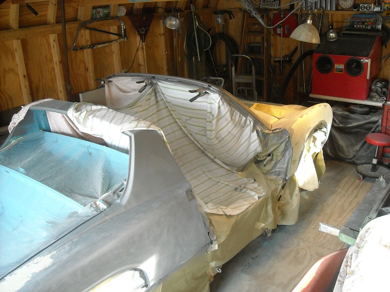

I am now working on the body doing body work and paint. I AM NOT A BODY MAN. I really don’t even like body work but think I am capable.
This is the hardest part for me. I would rather build engines. Most of my experience has been with Harley engines though and there just like big lawnmowers anyway...
Along the way I am learning to weld, machine small parts and paint and acquiring many new tools.

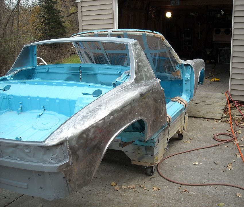

Started doing the bodywork on the Pass side, Trying to get out there on the warmer days. easier to heat up the shed.
Then I got a pretty nasty cut across the knuckle of my right hand middle finger. took 7 stiches to close.... (IMG:style_emoticons/default/headbang.gif)
Slowed me down a little, was supposed to have a brace on it for 2 weeks.... I didn't think about how much you use that finger. other than for waving at foolish motorists.
anyways every time I started working with it. I would open it back up. (IMG:style_emoticons/default/hissyfit.gif)
I know excuses are like assholes.....
but in spite of that I did get a couple things accomplished..

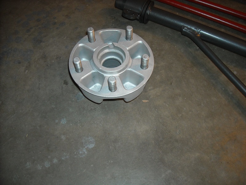

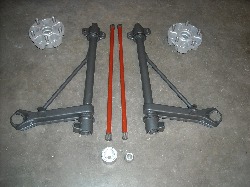

stripped the old bearings / races out of my hubs and bead blasted them.

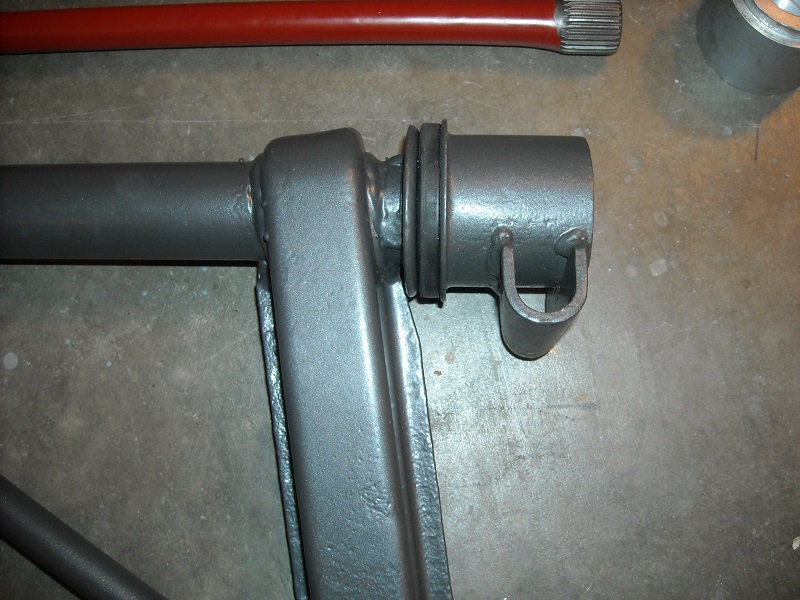

and installed my Elephant Racing rubber bushings in to my front control arms. Not as easy as in the video ( especially with this finger ) but still went pretty smoothly.
Question on the torsion bars, do the L /R markings go in front or in back?
